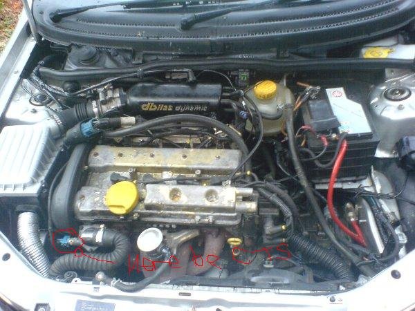

Right i think it came up with this, it flashed 1 pause then 4 which is coolent temp low voltage,...
Anyone got a picture of where abouts the little fuker is

6th Dec 05 at 14:26   View Garage View User's Profile U2U Member Reply With Quote
its the one on the thermostat.....
Siberia
Registered: 9th Oct 03
6th Dec 05 at 14:26   View User's Profile U2U Member Reply With Quote
the blue one ... here...

6th Dec 05 at 14:27   View Garage View User's Profile U2U Member Reply With Quote
