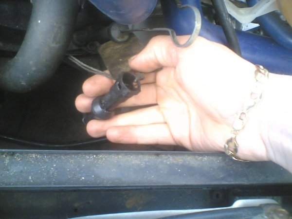

got some pics, could people please tell me where the following plugs and terminals go
that comes from the wiring harness, looks like it could go battery and hide the brown bit up??

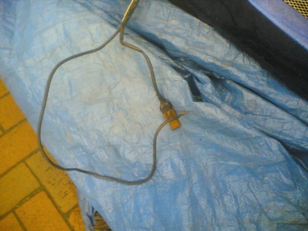

this comes from the sump (sensor on side)
no idea where this goes, looks like a single wire/pin??

First pic - Goes to + on battery the other bit is the RON plug, hide it away neatly.
Second - GOes to the gearbox speed sender

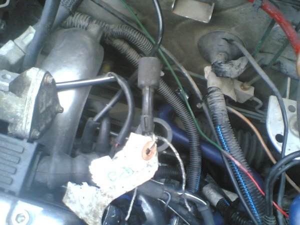

third - Ignition live for the ECU, run a wire from this to the black wire near the ECU

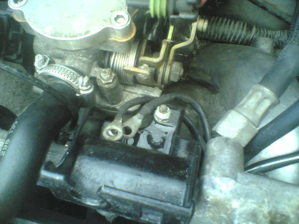

forth - Earth Straps for the injector rail. they bolt on just behin the fuel rail.

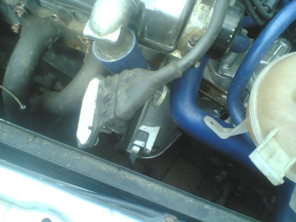

fifth - its the Amplifier for the coil pack.

5th is connected to summit already?

dont have a coil, im dispack?

then im guessing you take out the amplifier on the end of the connection ant plug it straight into the dispack as i believe they are built in. the loom must have been of a car with a Coil pack cos im sure thats one of these:

its from the same engine out of a running cav:S

not enntirly sure then mate, havent seen the engine bay of a late Cav valver. but its got something to do with that area.
