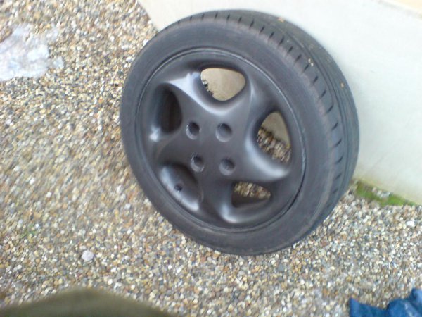

Hmm might go back to my origional plan of 205 gti's in gloss black then
£80 usually bags a set without tyres

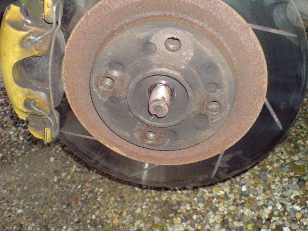

5th Jan 10 at 20:13   View Garage View User's Profile U2U Member Reply With Quote
Fears were confirmed they were wrong
Had to pay more from another company but I got the right one in the end

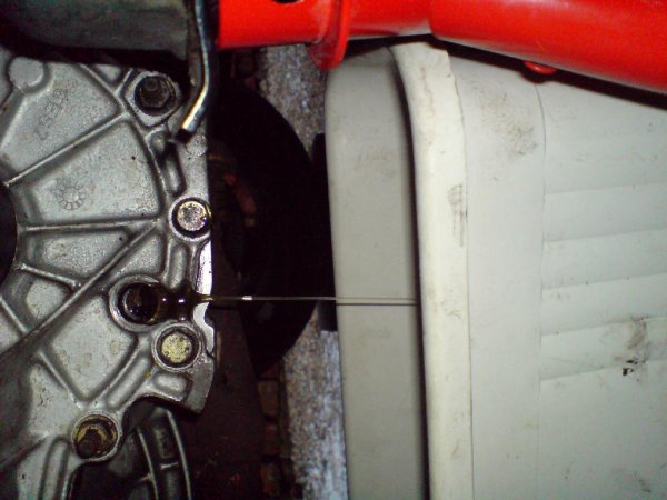

wheel off
oil out
(hope mother didnt want the flower trough )
Forgot how much I hate the smell also

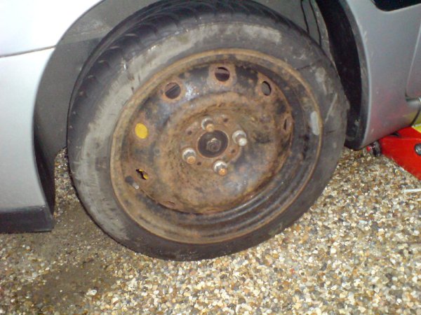

Euro rat look steely on so I can get to the hub nut and give is some welly
Swearing and metal pipe later

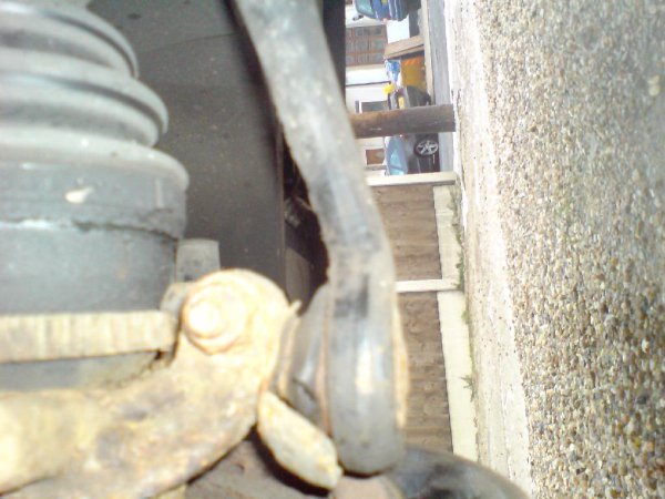

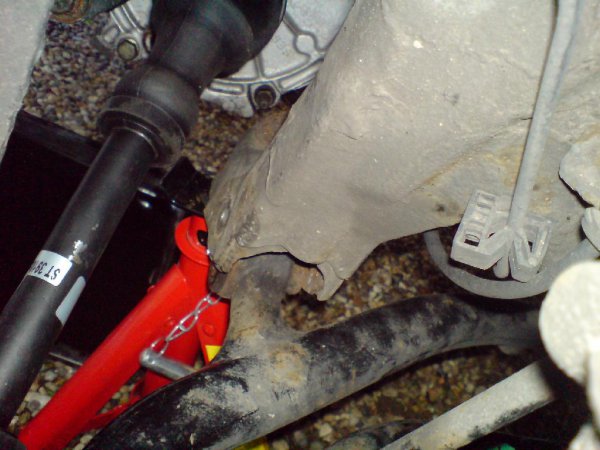

Biggest ball ache was getting these fuckers out and back in
cue lots of cunting
Lower arm off and new shaft in

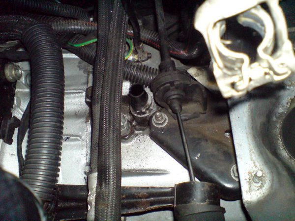

Cheat by filling box through breather
Check oil level
Put steely back on so I can get the torque checked by a garage tomorow as it needs to be 250 and my gauage dont get no where near that
All in all not a complicated job just lots of swearing at various seized components
Chris x

5th Jan 10 at 20:20   View User's Profile U2U Member Reply With Quote
Good work, did the shaft come already built up?
5th Jan 10 at 20:21   View Garage View User's Profile U2U Member Reply With Quote
They need a touch up as it goes
erm I used the big halfords cans think it was two and a bit of the big grey primers, three cans of ford graphite grey (small cans) and two laqures
5th Jan 10 at 20:22   View Garage View User's Profile U2U Member Reply With Quote
yer they are all one peice on these. all well and good til a boot goes or something, but considering these eat them its probably not an issue
