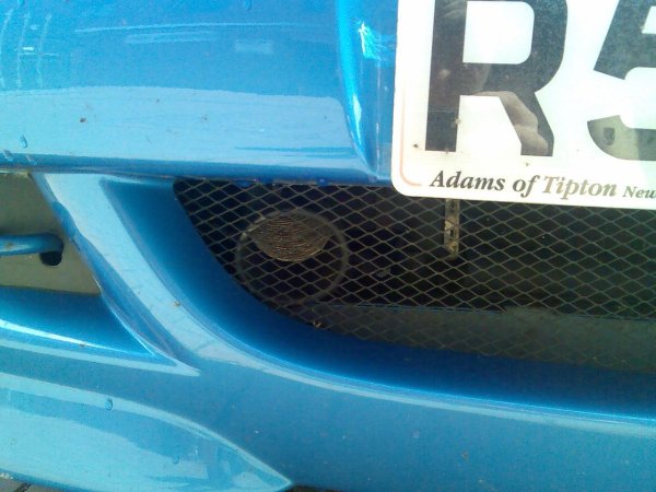

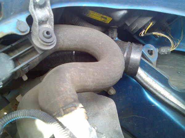

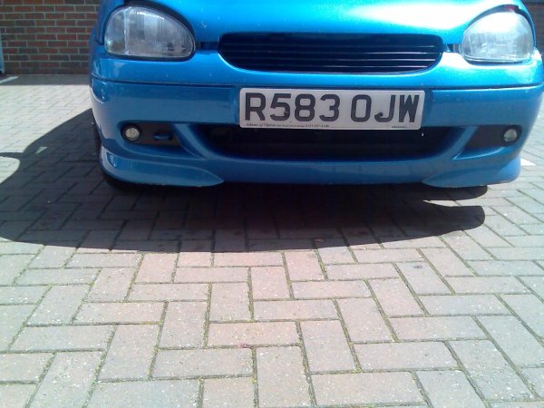

I have been asked many times how i have routed the cold air feed to my K&N.....you've worn me down i've caved in and taken some photos!!
I have an easier job than most as i have a Irmy front air dam with a lower grill but i'm sure if you had the tubing just below the lip of the bumper it would be very similar!
please enjoy these photos, hope it all makes sense!!
Just a quick shot of my front grill (bonnet is open yes!)

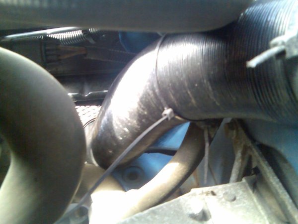

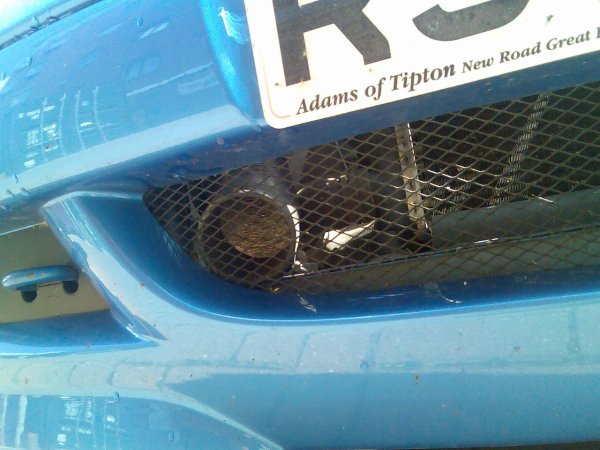

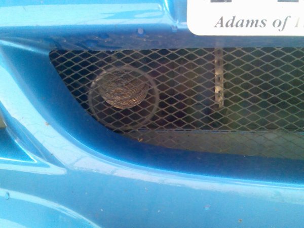

close up views of the cold air feed

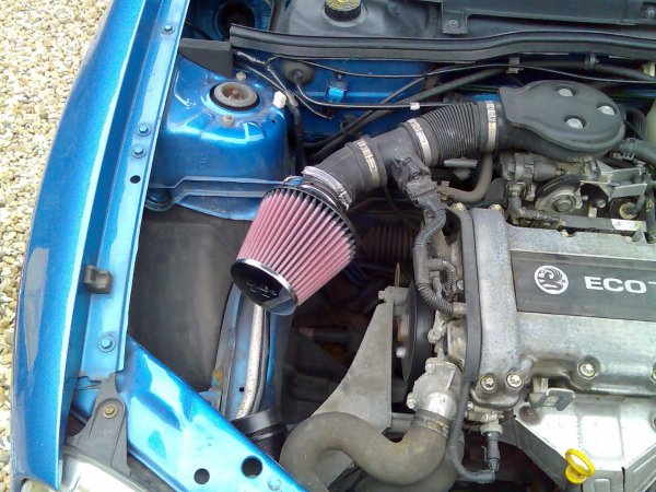

the other end of the feed is at the K&N

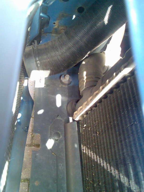

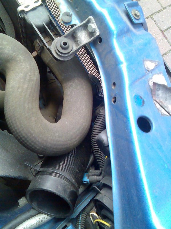

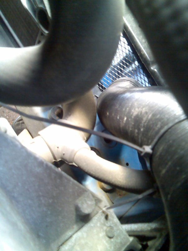

looking forward we see this sort of view
closer view(note the grill can be seen in these shots)
just as a final shot we can see the cold feed running along side the radiator from the grill upto the filter

think the cold air feed needs to be closer to the air filter?
p.s. standard corsa bumper has a lower grille so sin't much of an advantage
you can see my cold air feed coming from the front grille to the air filter.

1) the cold air feed i fitted match the instructions with the K&N filter. iirc stated no closer than 4inches, the pipe was oversized and so needed some simple cutting to get it to fit but i just followed the instructions. your kit may very well be different
2) please see my original comments
i admit the same format may not be ideal, but if you positioned it to appear under the bottom lip of the bumper is as good as the same.
I have been asked many a time how i have run a cold air feed - i've only posted what has been requested!
[Edited on 19-05-2007 by Fonz]
19th May 07 at 13:42   View User's Profile U2U Member Reply With Quote
yeah i read that bit after i posted and couldn't be bothered to edit because i'm lazy you see
i used to have my cold air feed positioned further away like your's but i kept getting terrible flat spots due to heatsoak etc so positioned it about an inch away from the air filter and now it's fine

Pete - is any of the cold air feed touching the radiator pipes? I thought of rooting one like that, but was concerned about it touching hot pipes.
Also, what did you use?

Deano - to my knowledge i dont believe the feed is impeded by any rad pipes.
everything used for installation was in the K&N 57i box with the exception of a knife to cut the cold feed tube to length!
