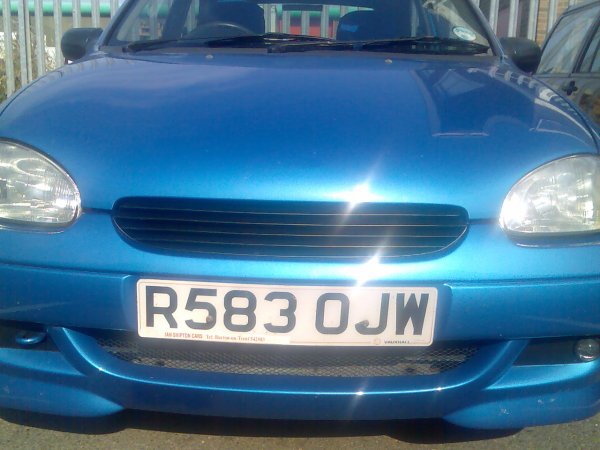

I've got a K&N fitted, see photo
u can just make out the "cold feed" pipe attached by cable tie
this runs down to the side of the radiator and is feed by the lower grill under the number plate shown in the photo below
my K&N kit came with the piping and just required some resizing and cable ties.
edit: NB the second photo does not show the piping as at the time of photo it was not fitted but would be seen from this angle.

that feed wudnt do much for the filter IMO. is that a 1ltr 12v?
Fonz
Registered: 12th May 06
Location: Newbury, Berks
10th Jan 07 at 00:17   View Garage View User's Profile U2U Member Reply With Quote
yup, any reason you say it would make no difference?
i only followed the instructions....placed the pipe no closer than 4 inches (if i remember correctly)
it actually suggested cutting away the bumper but i thought better of it and placed it in my grill.
[Edited on 10-01-2007 by Fonz]

i admit i had the ease with my air dam i have the extra lower grill.
the pipe that came with the kit was at least 200mm if not 300mm longer than i needed which would put it at the lower lip of a standard front bumper....just a matter of finding a cable tie point!
