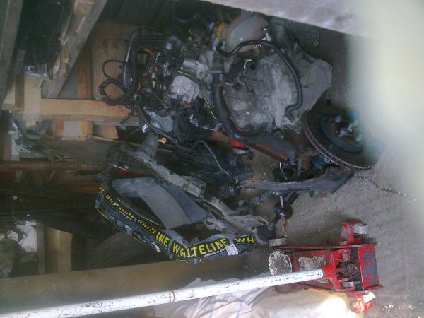

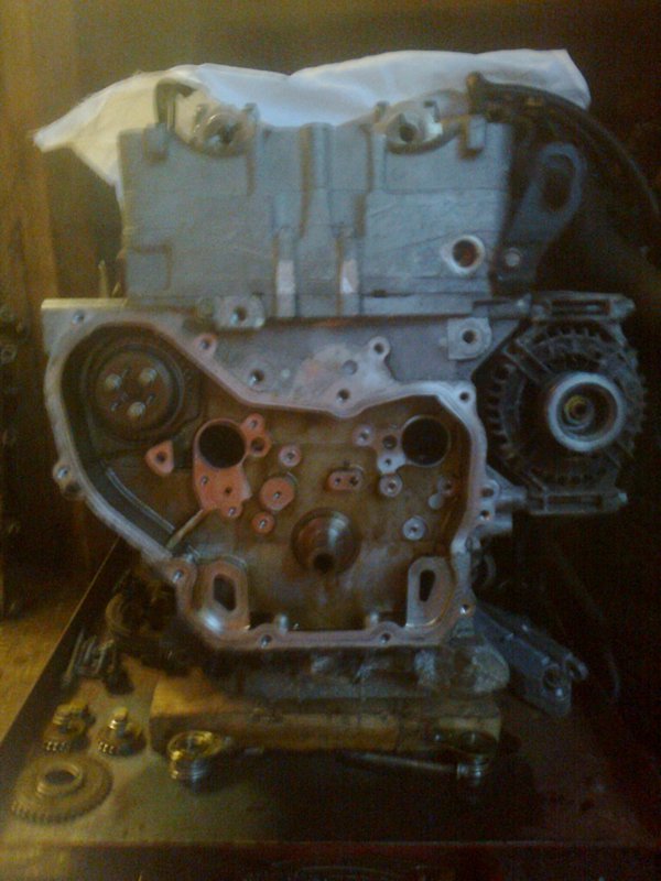

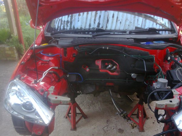

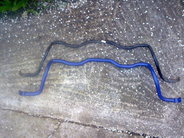

had some 'free time' sunday so made a start,
removed engine and gear box ready for new chains, remove balancer shafts, new oil pump, fabricate air con pump mount.
new atb dif to go in along with new gear box housing with top mount.
striped sub frame down ready for new H&R anti roll bar, also found drop link boots split AGAIN buy cheep buy twice!
engine has a new home for a few weeks.

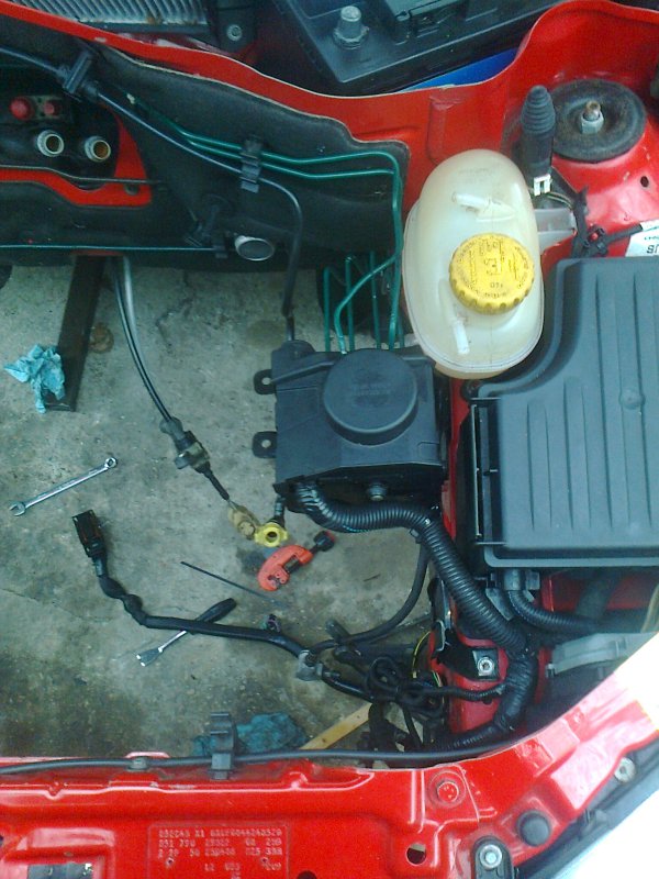

6th Apr 14 at 21:27   View Garage View User's Profile U2U Member Reply With Quote

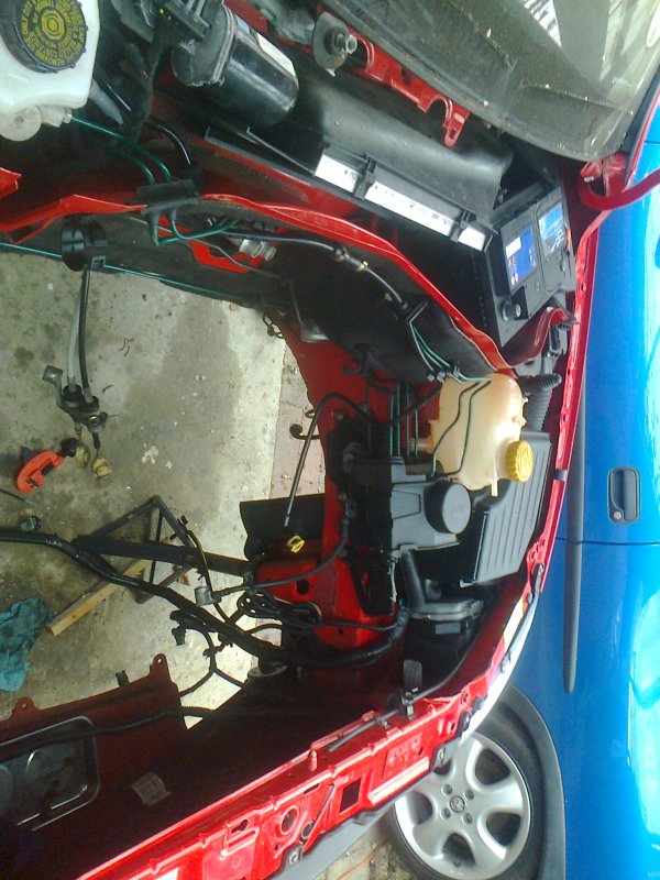

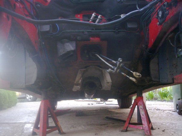

had a busy day working on the Corsa today, finished moving ABS unit, swapped gearboxes, which ment prepping Astra's box for the corsa, started doing timing chains and balancer delete, also measured up for air con pump mount bracket.
will post more photo's soon.

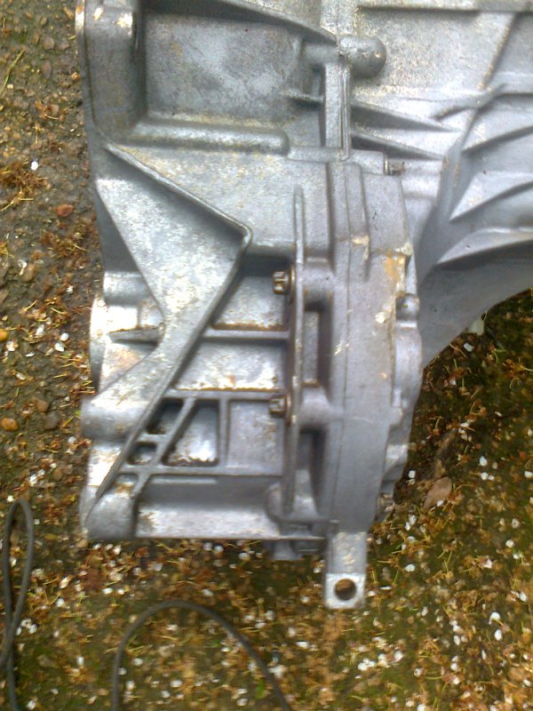

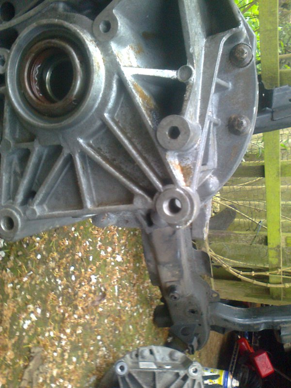

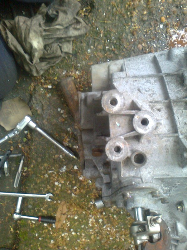

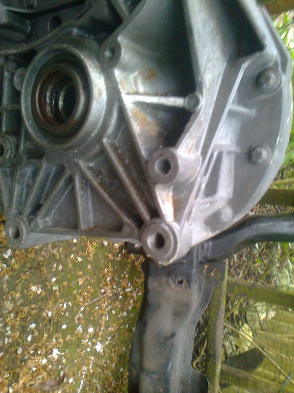

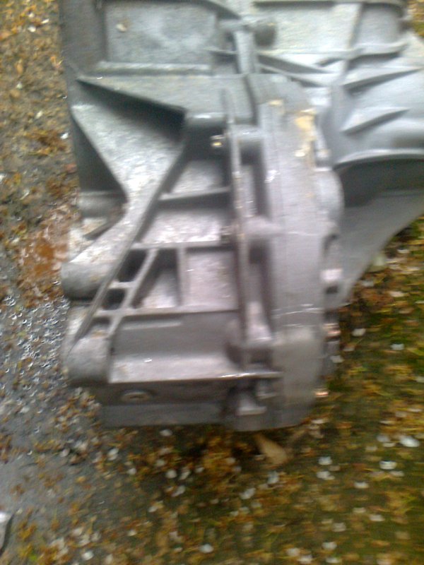

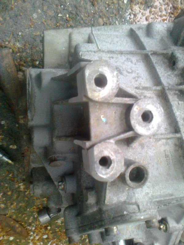

here's how to prep the F23 to fit the corsa C.
decided to use the higher final drive ratio box from an astra G too see what its like after the 4.17 ratio from the Vectra which its had since I did the conversion. also the astra box has the top mount point not the front end mount point. if I don't like it I can always fit the Vectra box with the astra end cover when I fit the quaiffe diff.
fisrt job is to remove the lug from under the rear of the diff housing
[img][/img]
[img][/img]
then the hole into the diff housing near the right hand drive shaft needs drilling and tapping M12 x1.75 for the rear corsa 1.7dti F23 mount.
[img][/img]
[img]http://[/img]

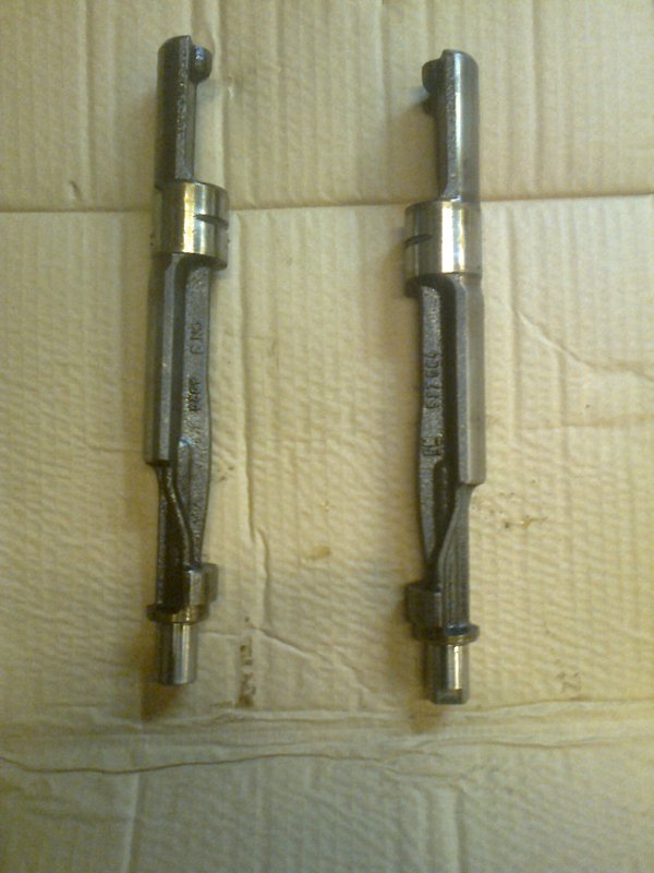

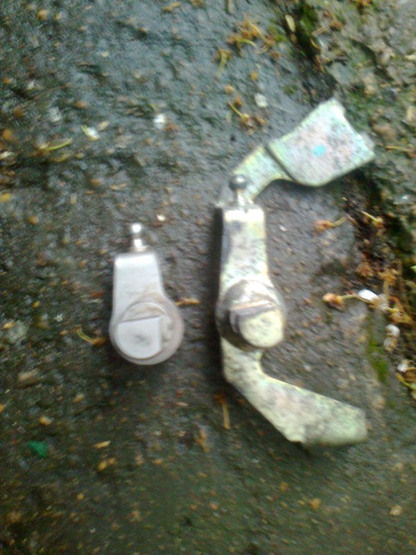

next is to bevel the edge of the top mount lugs so as to allow more clearance and movement when fitting.
[img]http://[/img]
[img]http://[/img]
I also fitted the Mtech short shifter kit from the old box which also gives more clearance when its all in the car. quite a lot shorter than standard item!
[img]http://[/img]
here's the Vectra and astra boxes together.
[img][/img]
swapped the clutch slave cylinders over as well as the bearing feels better on the old box plus I know when it was last changed.

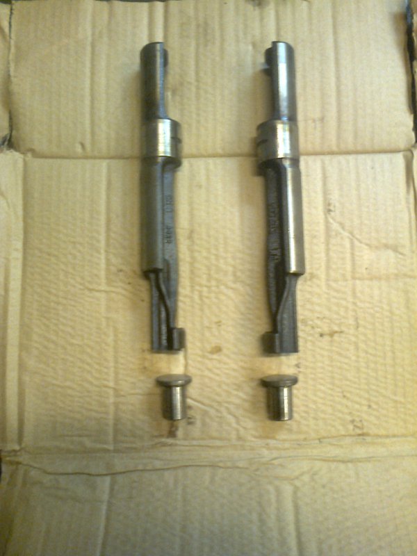

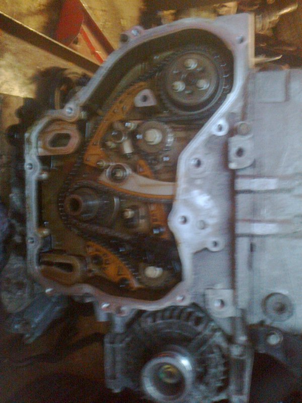

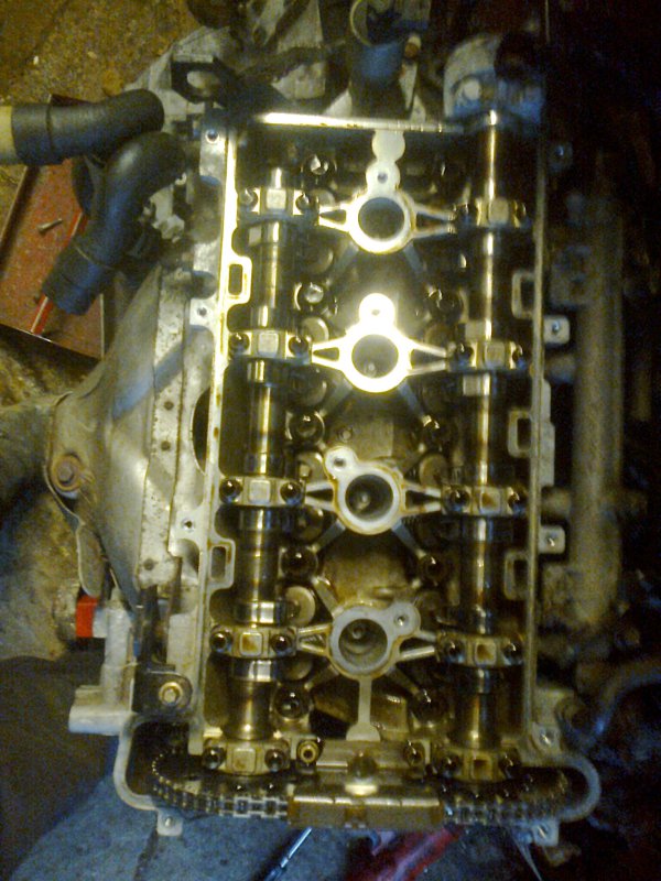

well, went to fit the new FIA timing and balancer chain kits today but that didn't happen!
knocked the balancer shaft bearings back buy 7.5mm to cover the oil ways, went to fit the now idler sprockets and no bolts in the kit
checked the rest of the kit and 2 guide rail bolts missing!!
then I checked the chain, more play than the old one!!
not to be put off I decided to remove the chain from the B207R engine.
all on then when torqueing the bolts 3 stretched!!
removed that kit and going to order a genuine GM tomorrow. nearly 3x the price but quality over cost.

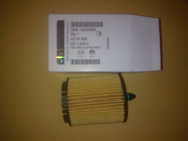

24th Apr 14 at 06:09   View Garage View User's Profile U2U Member Reply With Quote

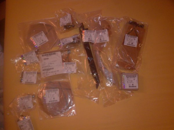

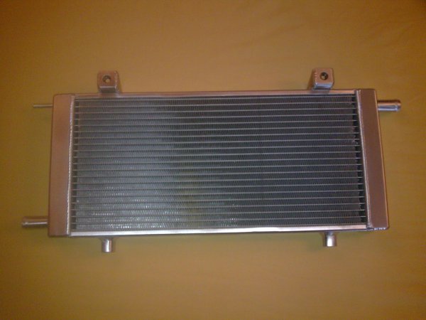

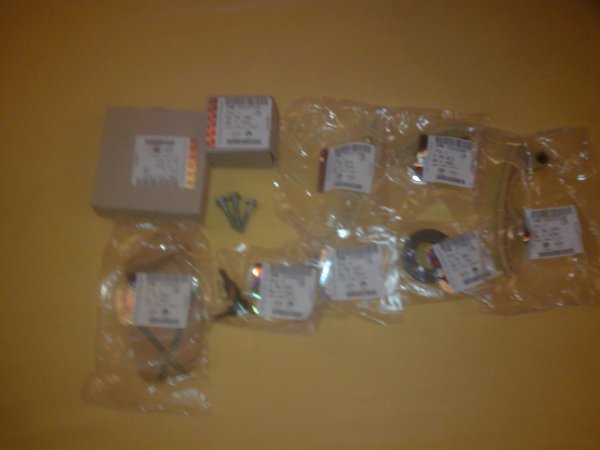

had some parts turn up yesterday
genuine gm chain set, no pattern part crap this time!
new oil filter and the custom made pre rad from pro alloy turned up as well
[img][/img]
[img][/img]
[img][/img]
[img][/img]
so im going to be busy fitting the chains and re fitting the engine over the next few days, hope to get it done before the weekend so I can take it to combe!
