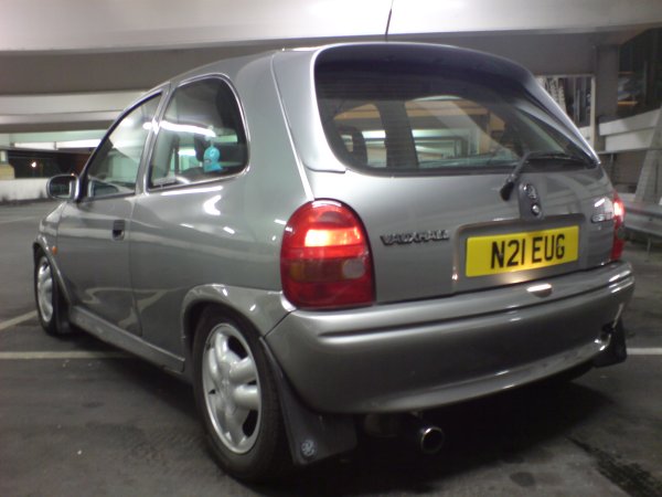

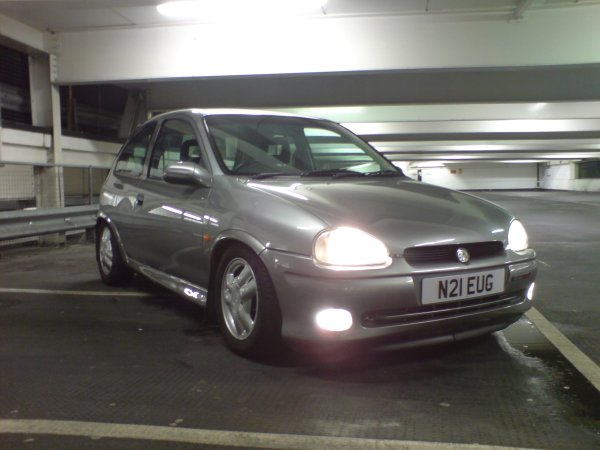

22nd Jan 08 at 22:55   View Garage View User's Profile U2U Member Reply With Quote
Eugine was a bit filthy from our pod outing at the weekend so I broke out the bucket and sponge aswell
Mucho betterz
23rd Jan 08 at 00:20   View User's Profile U2U Member Reply With Quote
thjat car park in basildon?
flybikeslee
Registered: 2nd Jan 07
23rd Jan 08 at 00:44   View User's Profile U2U Member Reply With Quote
looks awesome, repeaters let it down though, some smoked ones would look 100 times better
23rd Jan 08 at 01:54   View Garage View User's Profile U2U Member Reply With Quote
noooo, standard spec exterior FTW
Steve X16XE
Registered: 31st Dec 06
23rd Jan 08 at 01:55   View User's Profile U2U Member Reply With Quote
Yellow indercators FTW.
Fro
Registered: 20th Jun 06
23rd Jan 08 at 08:46   View User's Profile U2U Member Reply With Quote
Standard all the way Not many mint standard examples left out there
23rd Jan 08 at 09:51   View Garage View User's Profile U2U Member Reply With Quote
Westgate FTW
Was working a late at work so stopped off for piccies
ash87
Registered: 26th Mar 05
23rd Jan 08 at 16:18   View User's Profile U2U Member Reply With Quote
looks great
