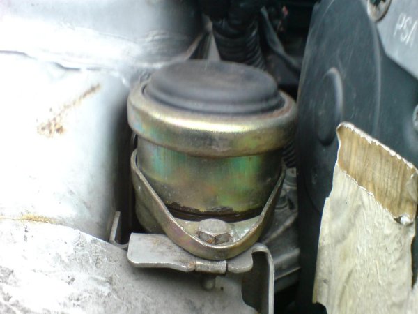

27th Jul 09 at 19:11   View User's Profile U2U Member Reply With Quote
one drivers side below ecu. one on the rear of the gearbox and one on the pass side below the battery.

27th Jul 09 at 20:11   View Garage View User's Profile U2U Member Reply With Quote
This is the one under the battery
So where are the other gearbox ones?

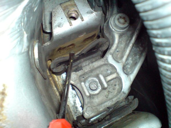

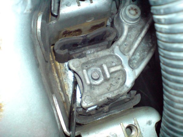

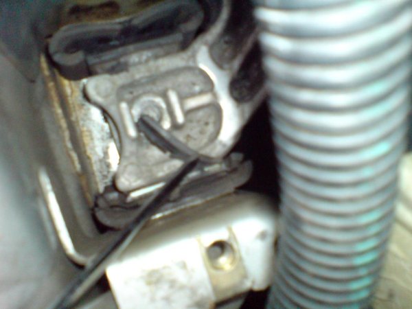

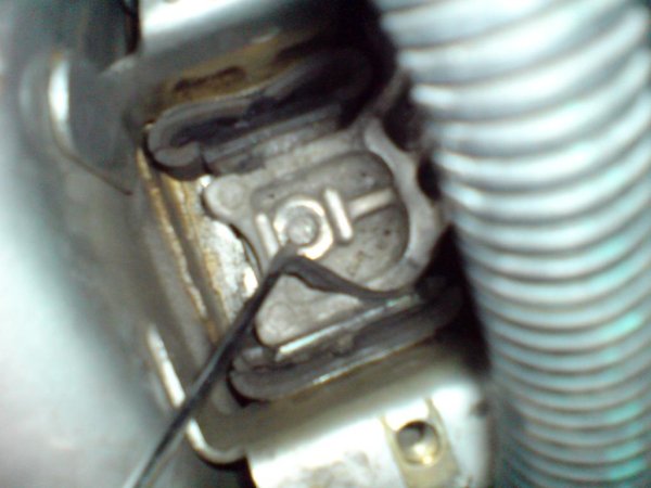

28th Jul 09 at 18:55   View Garage View User's Profile U2U Member Reply With Quote
Bingo Bango
Found the problem
Whipped out the ECU to look at the drivers mount and came across this
Big brass ball thing was loose
bolt going from in here
To the screwdriver end here
Broken
What do I have to replace the brass bit and bolt? or can I just get a bolt?
Also the rubber here is loose
Should that be replaced too?
And wheres the best place to get all this stuff?

28th Jul 09 at 20:56   View User's Profile U2U Member Reply With Quote
That seems to be a common one to go, my brothers GTI did exactly the same.
Cant remember what the layout of the GTI mount is again, its different on mine.
You dont need the buffer part anyways, it looks ok. Take the mount off the engine and take a look.
