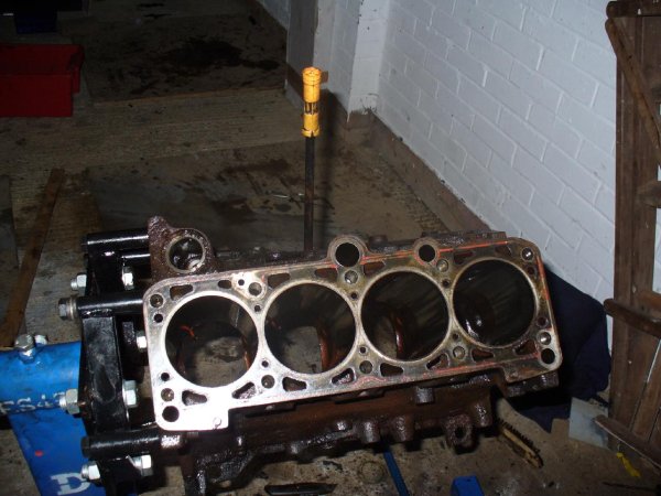

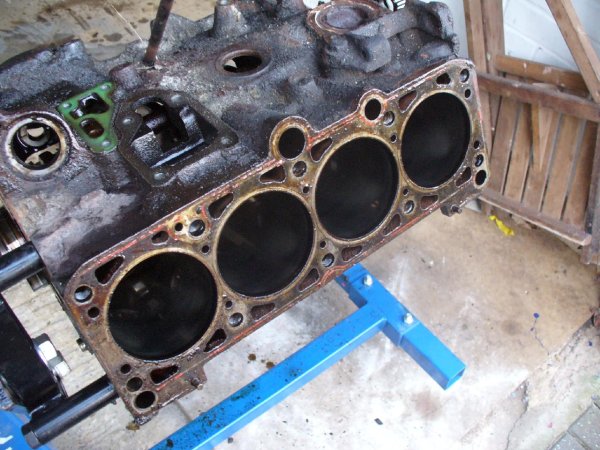

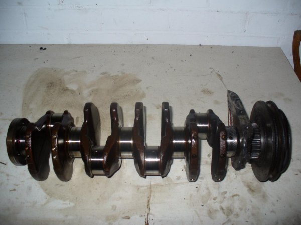

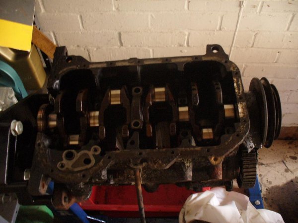

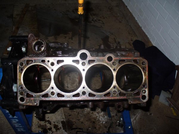

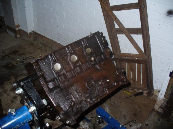

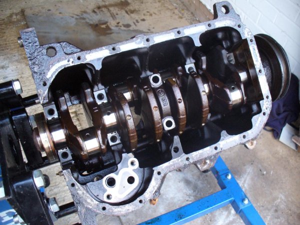

And finally, I have pictures of the engine in bits
Here's how I started -
As you can see, the crank was still in.
I had a slight issue with the crank pulley, I couldn't get it off, whatever I tried, so I had to work my way round that by wiggling, tapping with a hammer, more wiggling, then it came out (same way I got the cams out the head )
Crank out. Got the oil pump drive shaft out too, which was quite easy.

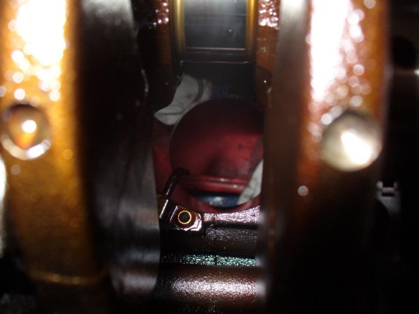

Quick pic of one of the pistons -
Pretty good considering the mileage.
I didn't know the KR had oil spray jets, so that's a nice thing to discover.

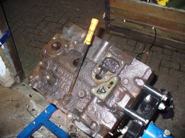

And a couple of pics of the block, which I can now clean up properly, as it's totally bare.

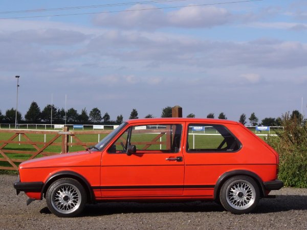

Now, before I did all this I decided my car wasn't sitting right, so I lowered it.
From this -
To this -
Not only does it look better, it turns in better (I turned the camber bolts round so it has more negative camber, not sure if that's done it) and it's not as bouncey.
Mod of the day TBH.
[Edited on 08-10-2007 by Robin]
8th Oct 07 at 19:30   View Garage View User's Profile U2U Member Reply With Quote
It's the front which has been lowered BTW, the pics don't show it as well as I thought they did
