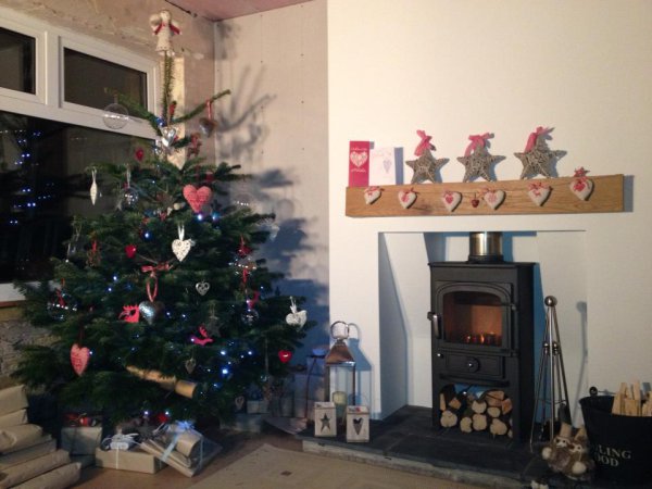

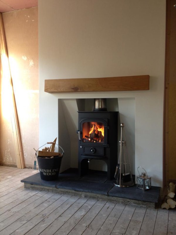

All in, I would imagine mine has cost about £2,000 to buy and install. Stove was £1250 iirc; then liner, vermiculite, register plate, adaptor, pot hanger, limestone hearth, fireboard, specialist plaster, oak mantle etc.

Looks amazing Lee, want one like that!
25th Nov 13 at 20:47   View User's Profile U2U Member Reply With Quote
That looks swish
Better than the Mrs parents bodge job!
