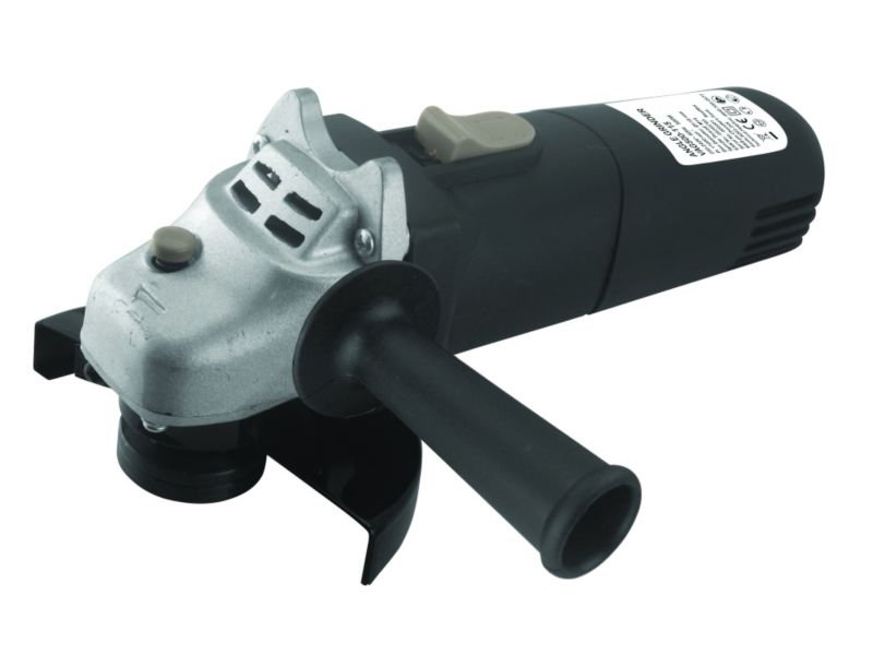

15th Apr 11 at 17:00   View Garage View User's Profile U2U Member Reply With Quote
£14.99
