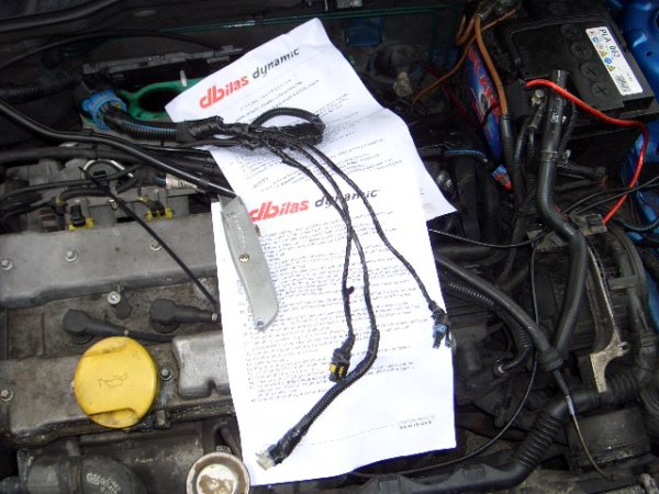

its the holes in the throttle body that needs drilling.
as for extending the loom, its pretty easy. just find the wires for the tps and icv and strip them back through the loom so that they will reach to the other side of the engine bay. ive got some pics, hang on...
Dave A
Registered: 10th Dec 03
28th Jul 06 at 12:17   View User's Profile U2U Member Reply With Quote
thats them extended, loads of usefull pics in my garage
