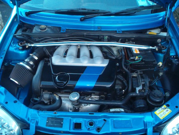

hmmm, its an X16XE so pretty cramped in the bay. Any pics mate pleeeeeeease

Ajones_17

6th Mar 06 at 15:58   View User's Profile U2U Member Reply With Quote
Can you show me on this pic mate
6th Mar 06 at 16:30   View User's Profile U2U Member Reply With Quote
should be somewhere within the red circle
Ajones_17
Registered: 20th Jun 02
6th Mar 06 at 20:08   View User's Profile U2U Member Reply With Quote
Cheers mate. I was looking round there but couldnt see shoot
