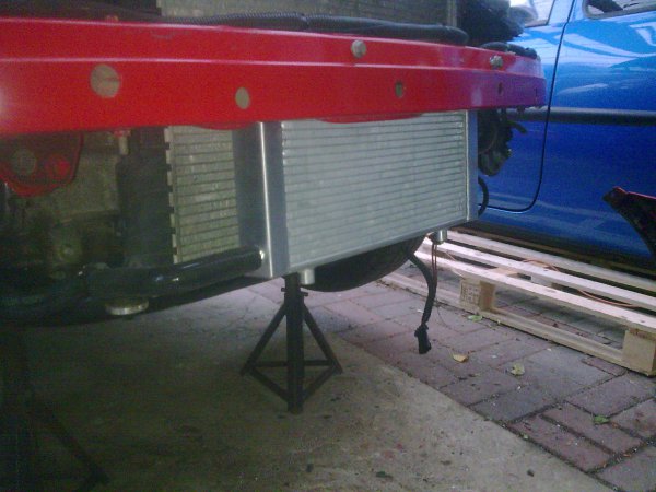

Chargecooler rad looks nice.

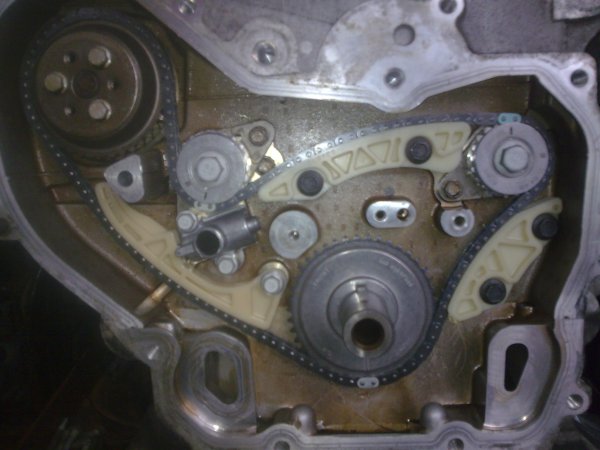

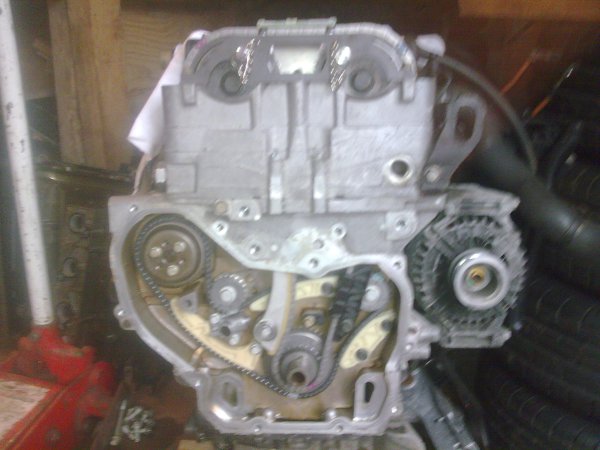

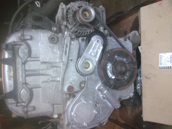

fitted the new chain sets, timed it all up,
[img][/img]
[img][/img]
fitted new uprated oil pump and drive belt tensioner,
[img][/img]

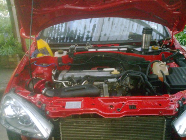

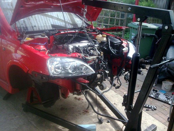

wheeled it out and lifted it on to the chassis mounts,
[img][/img]
[img][/img]
[img][/img]

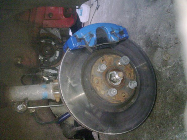

buit up sub frame with new H&R anti roll bar, new lower arms and new drop links,
[img][/img]
then started adding fluids, even a cup of tea for me
[img][/img]
hope to get it finished before it rains later today

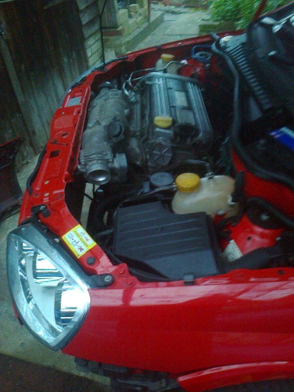

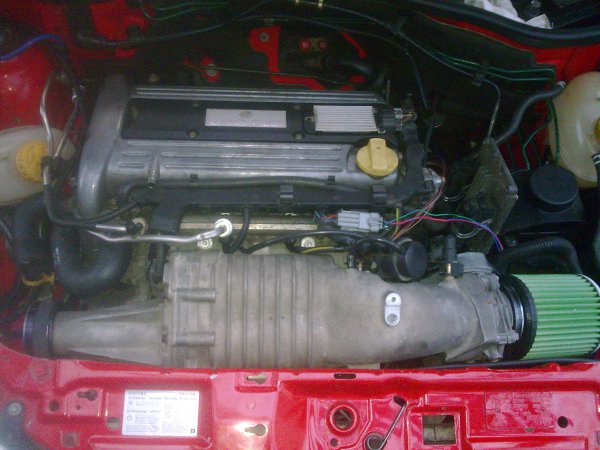

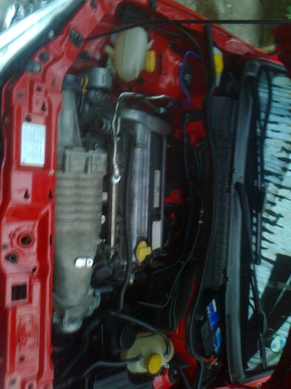

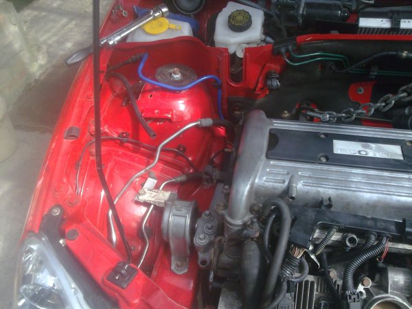

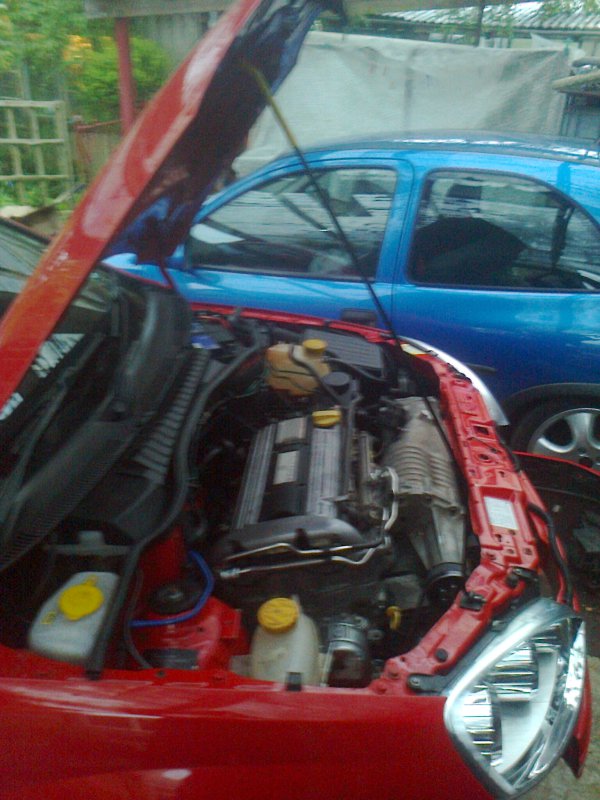

Well got it finished and had a good trip down to combe action day, passed mot so on with supercharger!
got manifold on, charger on, injectors in, fuel lines on, alternator on, belt on, planned radhoses.
[img][/img]
[img][/img]
[img][/img]
djgritt
Registered: 1st Nov 07
6th May 14 at 05:43   View Garage View User's Profile U2U Member Reply With Quote
That looks like a bit of a squeeze!
davegreen
Registered: 20th May 12
Location: Oxfordshire
6th May 14 at 20:26   View Garage View User's Profile U2U Member Reply With Quote
I like it tight at the front!

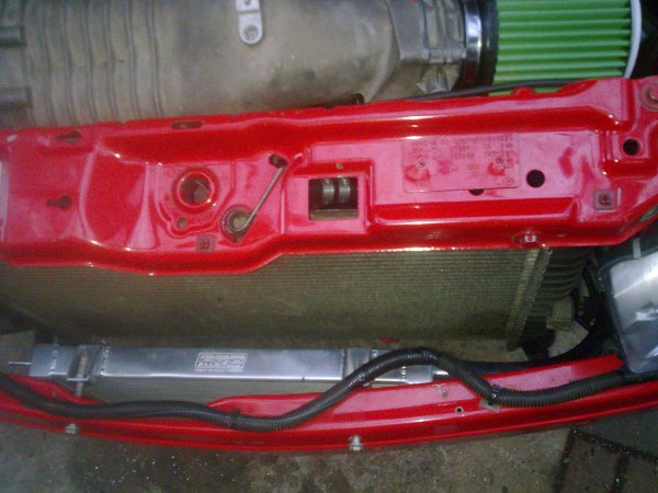

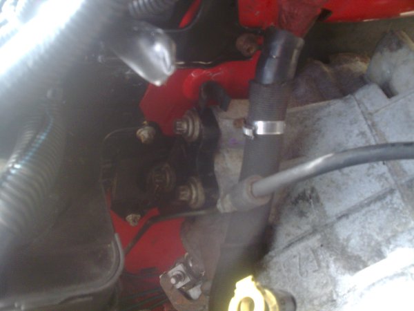

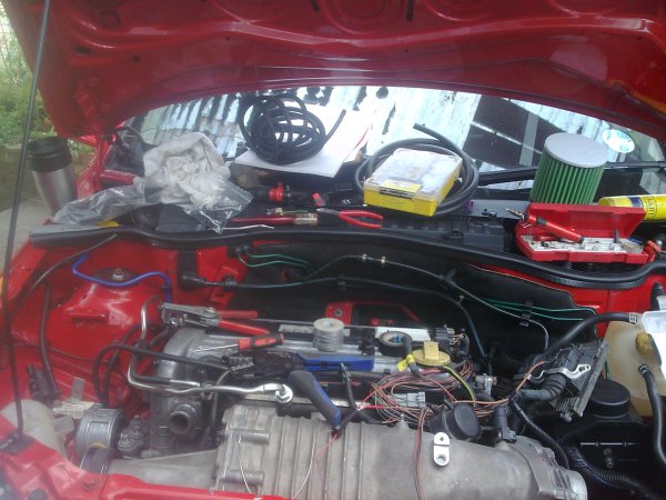

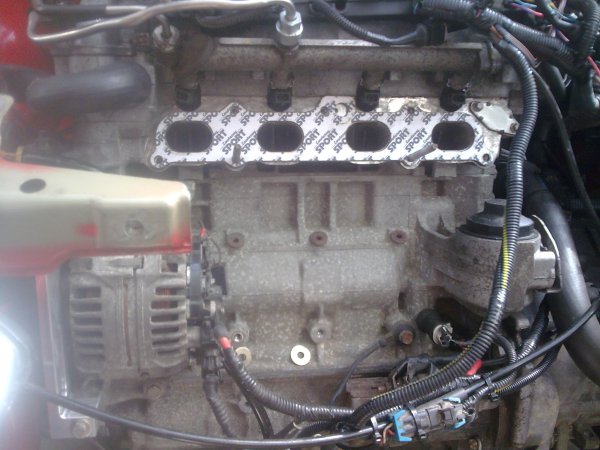

had a few hours again today so started by plugging the map sensor hole in the charger, used a 10mm core plug stretched to 10.2mm along with Loctite bearing fit, then fitted the new map sensor in to the manifold.
simple jobs done, so on to the wiring loom which has to be re routed and have some wires lengthend to suit new location of ECU, also fitted new plugs for the z20let injectors, new coolant pump for the charge cooler.
found a green cotton air filter which fits in the space made from moving the ABS unit, not the ideal type or size but it fits! started plumbing up the charge cooler and prerad had to move main radiator back to make way for the new Kenlow 10" fans between the 2 rads.
[img][/img]
[img][/img]
[img][/img]
[img][/img]
[img][/img]
looks like fitting air con has gone out the window now, no room for the condenser.
Generation
Registered: 7th Jul 09
11th May 14 at 20:36   View User's Profile U2U Member Reply With Quote
Remove the crash bar?
davegreen
11th May 14 at 20:45   View Garage View User's Profile U2U Member Reply With Quote
could do that but the pre rad is mounted on it

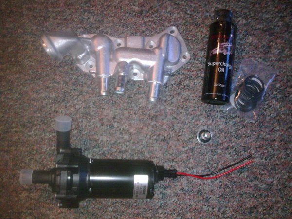

got these parts today, not bad as I ordered them Monday from USA!
[img][/img]
dual pass end plate, larger coolant pump, magnetic sump plug and oil for the charger.
the reason why it all needs to come off, more power!

have you got the bracket for the pump too?
nice work, i enjoy reading this
davegreen
23rd May 14 at 19:32   View Garage View User's Profile U2U Member Reply With Quote
bracket is already fitted with smaller pump in it, got this one as its higher flow than standard gm pump.

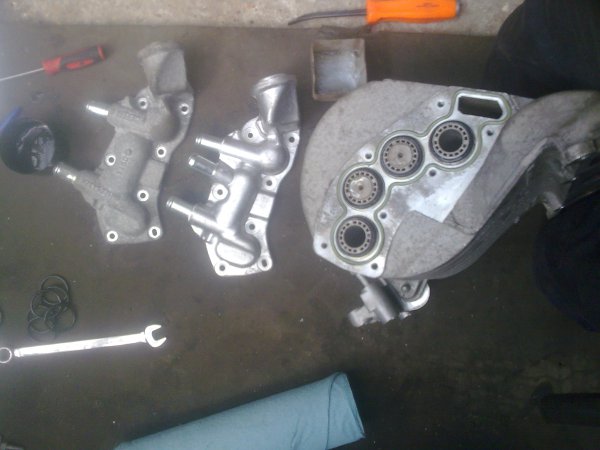

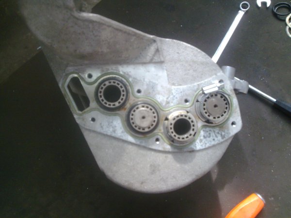

charger is off, removed manifold to do dual pass mod.
[img][/img]
[img][/img]
used a jubilee clip to grip the laminova cores to pull them out, gave them a quick clean fitted new O rings top and bottom then reassembled after turning 2 of the cores around.
[img][/img]
fitted new end plate and refitted to the engine, made a few other mods to the drive belt and plumbed up the new water pump for the charge cooler, started re wiring the front of the engine as I wasn't 100% happy with it trial fitted the radiators and front bumper.

So why does the new cover have a extra hose take off on the inlet?
davegreen
26th May 14 at 08:31   View Garage View User's Profile U2U Member Reply With Quote
its whats known as dual pass, water goes in the middle passes along the 2 centre cores and back through the upper and lower core and out the top and bottom pipes, on the standard one it goes in the bottom and passes through all 4 cores in turn then exits at the top (quad pass) more cooled water in means cooler air to the engine and more BHP. 10 more is whats claimed!

got thick thermal gaskets on where the charger and inlet bolt on? if not they a good investment to keep it cooler
Warren G
Registered: 14th May 06
26th May 14 at 08:55   View User's Profile U2U Member Reply With Quote
So it has a charge cooler built into the inlet manifold?
davegreen
26th May 14 at 09:05   View Garage View User's Profile U2U Member Reply With Quote
yes jed, and m8 studs not the standard m6 ones most people use and then suffer from gasket failure due to poor clamping force.
yes warren, standard feature on gm supercharges on these engines I've improved it though!
