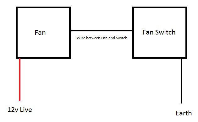

see if this makes any sense
oh and there is power on the live to the fan aswell
ran out of space
[Edited on 13-04-2011 by JedDy]

if you have taken the plug from the fan switch on the rad and bridged them and the fan comes on then it's either the switch is faulty or no hot water is getting to the switch.
This test would prove that all wiring is OK because all the fan switch does is join the two wires together when it gets hot.
[Edited on 13-04-2011 by RKS]

it didnt work before and its just had brand new gm switch and rad so cant see it being that. cheers anyway though
edit- please note the pic was taken before all the work was done.
