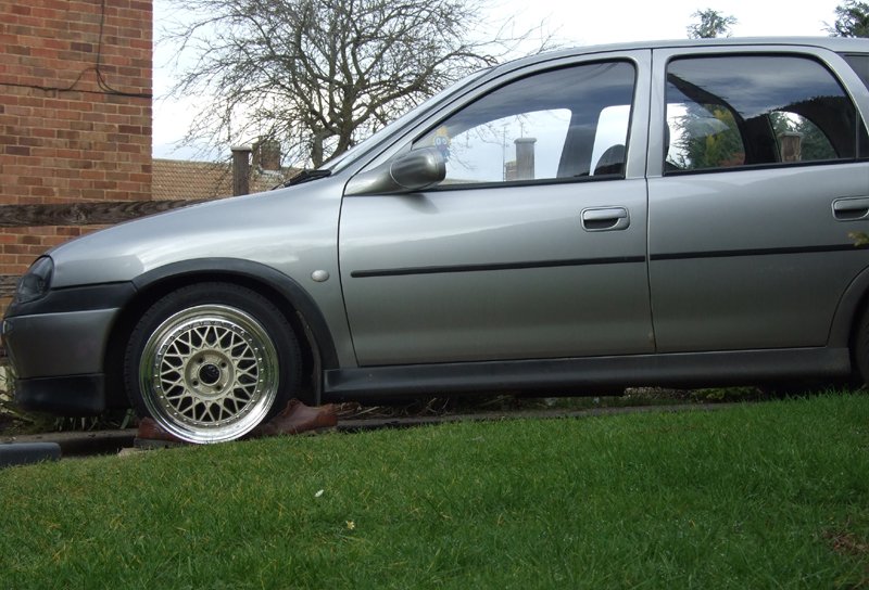

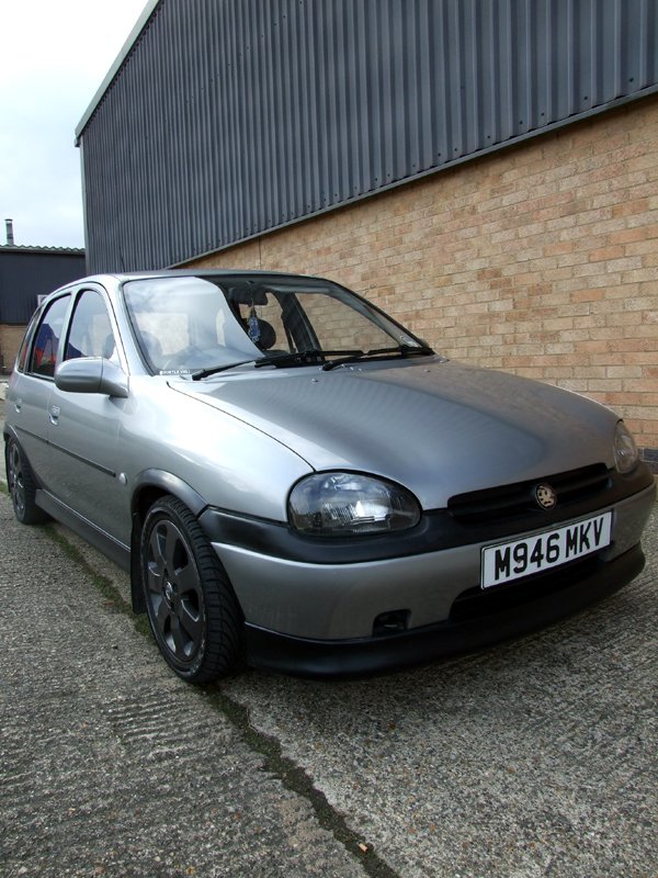

offered a wheel up to the car today, just to get an idea of the 2 colours together, so far im very pleased

Works well - could always have done them smoke grey if not I suppose!!
Feel you need the post 97 rub strips on your car to match the rest of the chunkier looking black trim

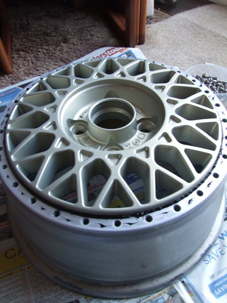

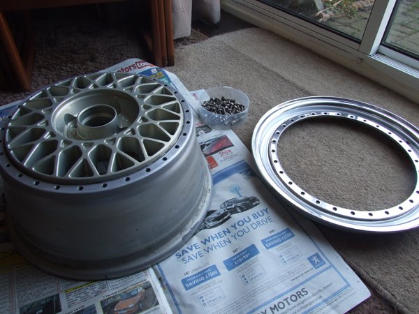

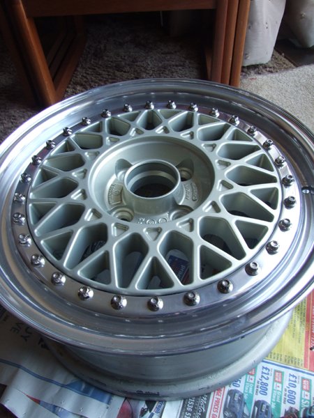

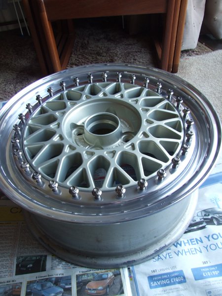

update from a few days ago .. Wheels Built
first off make sure the rim is clean & apply a silicon sealant around the inside edge .. also a dab between the bolt holes
place the dish on and start off all 30 bolts
bolt up the wheels & torque up each bolt, leave to set and place a bead of sealant on the joint inside the rim
job done

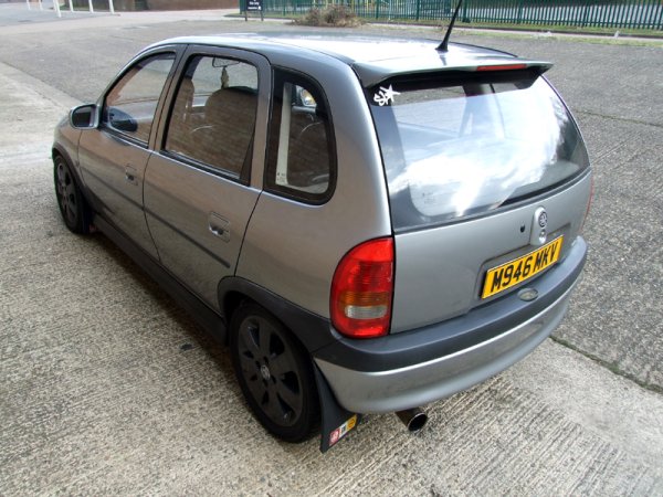

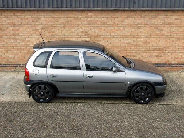

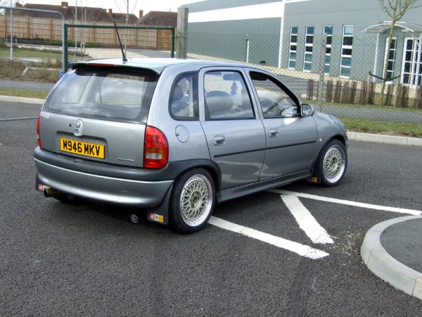

Todays update:
tyres were fitted this morning so i spent today cleaning and putting the RM's on the car, went out for a quick drive and all is well no scrubbing
very pleased with how they have come out .. oh and center caps are now fitted

Looks good cant help but think it will look 100 times better with post 97 rubstrips or them removed all together

your car is absolutly imaculate Danny, just keeps getting better and better, think i spotted the bug near Highan Ferres (sp) the other morning,

nice one bud, they look absolutly mint
lower on the front tho mayb? lol

I prefer the old wheels for some reason >??? lol
Deffo agree with scotty about the rubstrips too

thats looks fucking smart
possibly a touch lower at the front, but looks ace, and id go for post 97 stripes not removed.

not feeling the mudflaps and ride hight dude..
wheels are looking nice though, not much strech on the tyres or is there?
lower it to this mate if you can..
