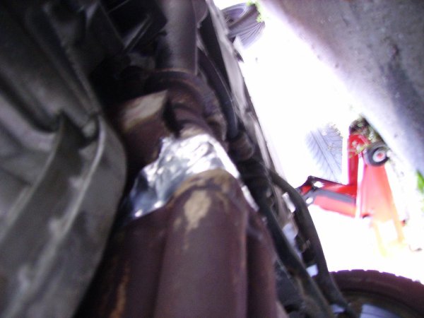

Only thing going wrong been the GMC 4-1 manifold cracking
So all in all the french box did alright. Going to take it somewhere to get the manifold welded and then it should be back to health

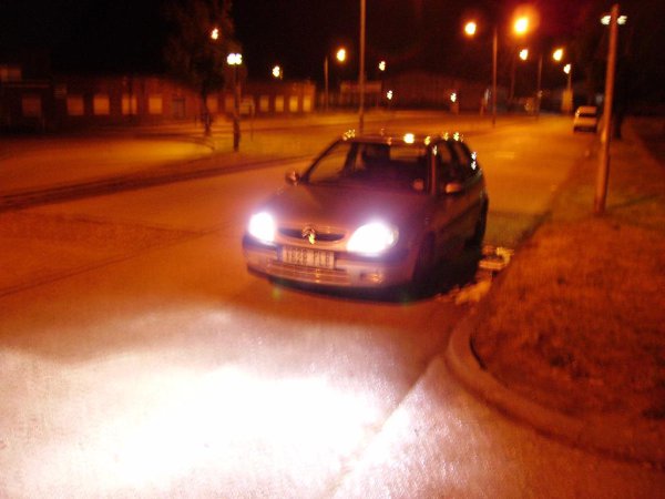

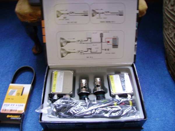

Spent £80 on it today hower as its due a service and the lights have always been shite so bought a set of hids as they were only £40. As the longest day is here already the nights will draw in again soon

Refitted all the exhaust so its sitting nice and did a little bodge to stop the manifold sounding so shit for the moment until its welded
Then fitted the hids

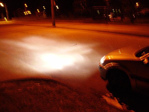

Just awaiting it to get dark now so I can check the beam and see if they are any good

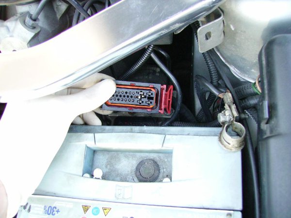

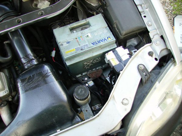

Happy with the drivers side as I have hidden it all away under the ECU so it looks nice and OEM
Passaner side I couldnt find a location for that I liked so it is temporly attached to the alarm siren. Need to have another look in the future to see if I can find somewhere better

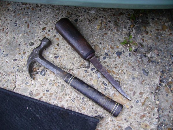

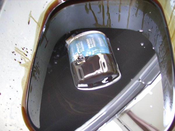

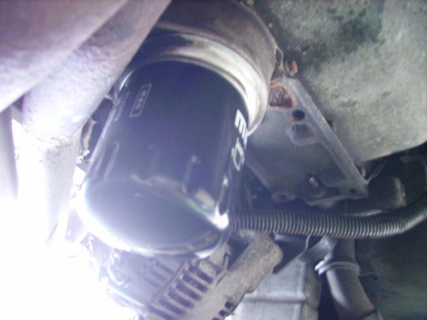

All was straight forward until I couldnt get the oil filter off. Think they hired Halk Hogan to fit it last time. Even the tool was slipping
So bought out the medieval tools and got down the dirty

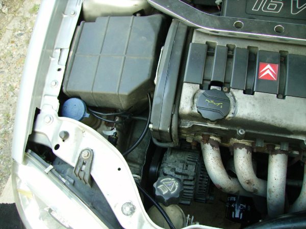

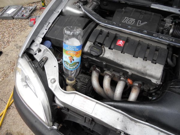

All thats left to do is change the coolent. Manufactured myself a header tank from a robinsons orange bottle and am all good to go when I get time

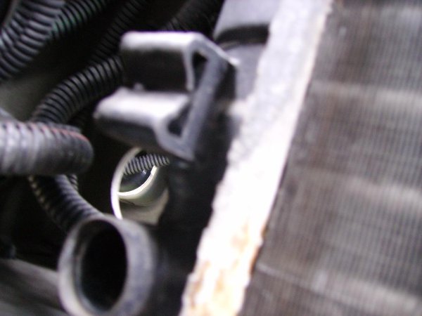

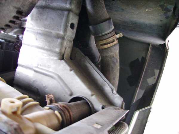

My rad doesnt have a drain plug though it seems
So I think I should just be able to pop the hose off here to get the same effect
Anyone know where the drain plug is on the head on the 16v models?
Also couldnt change the AUX belt as someone has rounded the fuck out of the tensioning bolt. So I am going to get a new one before I attempt anything there.

There's a drain plug on the righ of the block and one top left near the inlet manifold.

Down by the aux belt kind of area?
Then there are the bleed points by the inlet mani, thermostat and top of the rad yer?

Finally got round to doing the coolent change. Sounded complicated with bleeding the system but it was easier then I thought.
Made a home made expansion tank to avoid paying shiteron the £23 they wanted for the proper one. Insulation tape to make a tight fit and a drill + hacksaw ftw

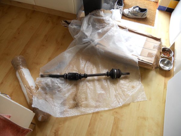

Was going to fit the driveshaft that I bought from ebay next but

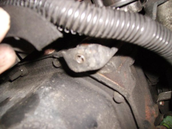

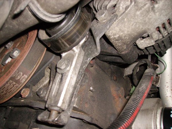

Also still need to figure out how the hell I am going to get this rounded off bolt out of the bottom of here
Mertin
Registered: 12th Oct 05
21st Jul 10 at 17:37   View User's Profile U2U Member Reply With Quote
What bolt is rounded in the pic? Small socket hammered onto it?
21st Jul 10 at 18:34   View Garage View User's Profile U2U Member Reply With Quote
its not really in that pic, in the botton of that assembly there is a allen key headed bolt. It runs up inside that silver shaft and tensions the pully on the belt by pushing up on it.
This one
There isnt really anywhere to get pliers round it or anything
21st Jul 10 at 18:40   View Garage View User's Profile U2U Member Reply With Quote
so its rounded inside the allen key bit?
Mertin
21st Jul 10 at 19:02   View User's Profile U2U Member Reply With Quote
Try hammering a torx bit into it and should grip the sides
21st Jul 10 at 19:40   View Garage View User's Profile U2U Member Reply With Quote
Yer completly rounded in the allen key bit
Who ever did it up before was a fuck tard
Got a couple of pics of the lights in use the other night too, phone wasn't a fan of the dark mind

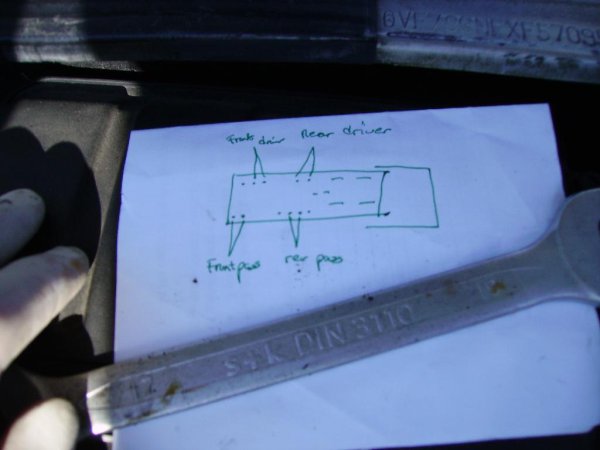

also for people with abs problems I copied off a wiring diagram and tested the resistance of all of the sensors from the main plug this:
A) means you dont have the crawl under the car
B) you test all the wiring too
Should all read a resistance of around 1000ohms. Front right read zero so new one from the scrappy and all is well again
