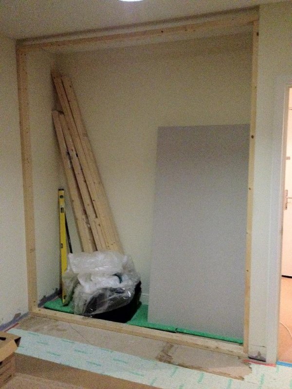

outer frame

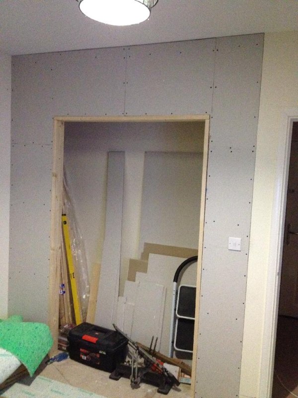

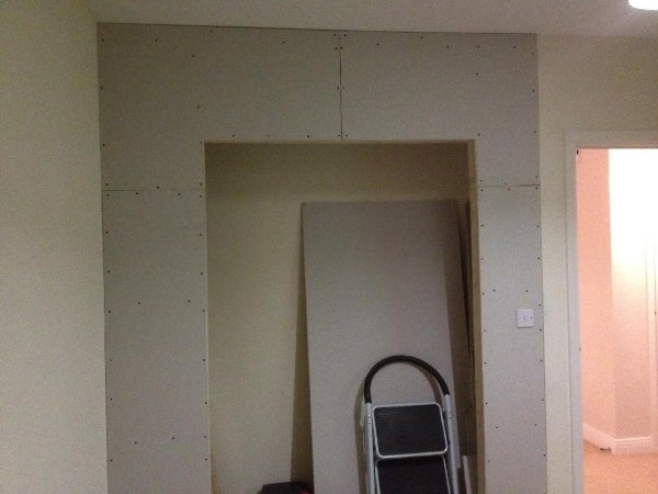

didnt take any of the stud but heres the plasterboard on
had to move the light switch too, which was fairly easy, just drilled a tunnel through the three bits of stud, two existing and one that i put in.
wasnt happy with the gap on the right hand side though so put a new bit up and fitted the door frame

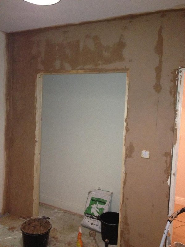

and finally the plaster which i did yesterday,
was quite hard to start off with, and started inside the wardrobe as it wont really be seen, but it was quite awkward working in the tight space.
soon got the hang of it though.
i wouldnt like to do the ceiling or a complete room though, i would leave that to the pro's

Did you tape the switch up then plaster round it?
Tomnova16
Registered: 21st Jan 06
12th Dec 11 at 11:20   View Garage View User's Profile U2U Member Reply With Quote
lol
nah i needed the light on so released it from the wall and taped in the case thing to stop any moisture getting inside and taped the switch up
Located in Chalfont st Peter
John
Registered: 30th Jun 03
12th Dec 11 at 11:24   View User's Profile U2U Member Reply With Quote
That's alright always hate seeing that.

i was pissed of with the previous painters not even masking up the sockets and switches let alone releasing them from the wall.
with regard to paint tihe plaster is 48 hours long enough
ill put a coat of thinned 2:1 vinyl matt (waterbased) on before the colour

12th Dec 11 at 13:28   View User's Profile U2U Member Reply With Quote
done a good job there tom. i would leave it a little longer than 48 hours personally. probably give it 3 days just to be sure.
Tomnova16
12th Dec 11 at 13:35   View Garage View User's Profile U2U Member Reply With Quote
makes me wonder how they do it in time on DIY SOS
RichR
Registered: 17th Oct 01
12th Dec 11 at 13:40   View Garage View User's Profile U2U Member Reply With Quote
DIY SOS had that question raised once as they were painting so quickly onto wet plaster. They use a massively watered down paint (5:1 iirc) and then leave them with paint to finish it at a later date

Are you putting a pair of doors on it?
Tomnova16
12th Dec 11 at 21:54   View Garage View User's Profile U2U Member Reply With Quote
Yeah. Just marking out the hinges now
Gary
Registered: 22nd Nov 06
12th Dec 11 at 22:08   View Garage View User's Profile U2U Member Reply With Quote
No door case? Or you just running a batton round the stud work?
Dave
Registered: 26th Feb 01
Location: Lancs
12th Dec 11 at 22:41   View User's Profile U2U Member Reply With Quote
It's got a lining, just needs a lath planting on to form the rebate. Probably easier that way for a diy'er. Hang the doors then just fit the lath up to them, no risk of getting them hinge bound that way.
Tomnova16
12th Dec 11 at 23:40   View Garage View User's Profile U2U Member Reply With Quote
Put the rebate thing on before the hinges.

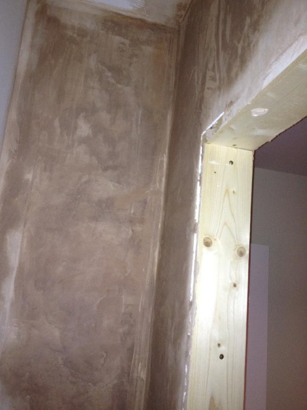

sorry for the crap pic but this shows the rebate thingy

What are you going to use to keep the doors shut?
Tomnova16
13th Dec 11 at 21:26   View Garage View User's Profile U2U Member Reply With Quote
Magnets
