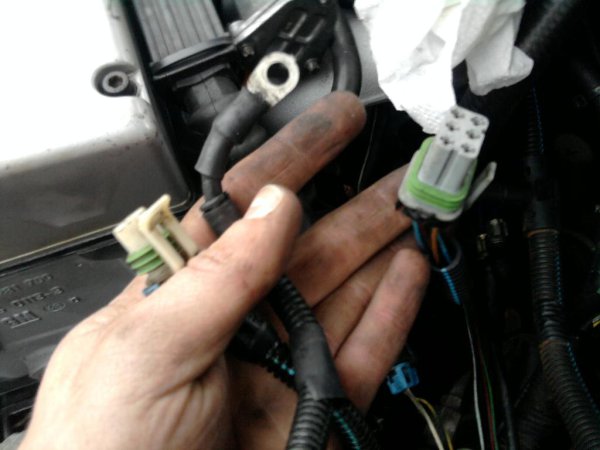

In the drivers footwell there is a plug that looks like this:
unplug that all pull the loom up through the bulkhead into the engine bay.
Then at the back of the engine, there is a plug(on the right in the pic below)
Follow that plug back to the alternator and starter motor and remove it from them.
The rest of the wiring can go with the engine as you WILL NOT need it
Hope this helps

8th Mar 12 at 13:37   View User's Profile U2U Member Reply With Quote
I've taken out that main loom that was linked to the ecu,so now that terminal and the 2 plugs you've pictured is that what I leave in the car and the rest I don't need?

8th Mar 12 at 15:33   View User's Profile U2U Member Reply With Quote
the plug on the right will stay in the engine bay but yes with the car
