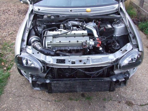

the turbo to cooler pipe was all over in this pic but you get the idea, I used a twin core gsi rad and had to be moved to the middle didn't want to cut my bumper so had to push the rad back a bit as well so its quite close to the turbo but not to bad, also have a 8'' slimline fan to fit
