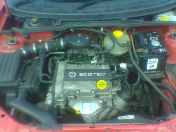

11th Oct 09 at 11:36   View User's Profile U2U Member Reply With Quote
I know.
Why would the software update work if it has 'suddenly' just started happening?
Under the plastic bit circled in green is the throttle body isn't it?!
alan-g-w
Registered: 9th Nov 07
11th Oct 09 at 11:53   View User's Profile U2U Member Reply With Quote
yes
