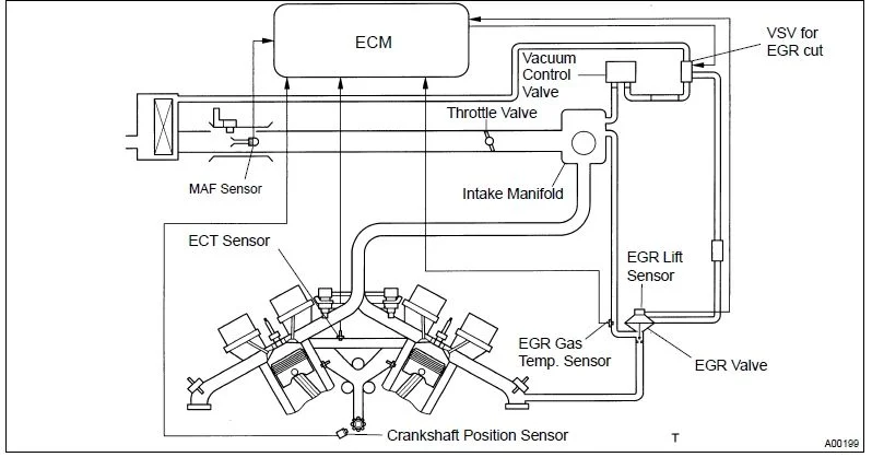

EGR exhaust gas recirculation send some of your echaust gas back into the cylinder to get burned for fuel economy to anything getting pushed out by the psiton is passing through the egr valve so the metal could be bits of piston or valve
look at the link below that shows you the route of the exhasut gas and what it passes through
http://forum.ih8mud.com/attachment.php?attachmentid=330648&d=1244360546
