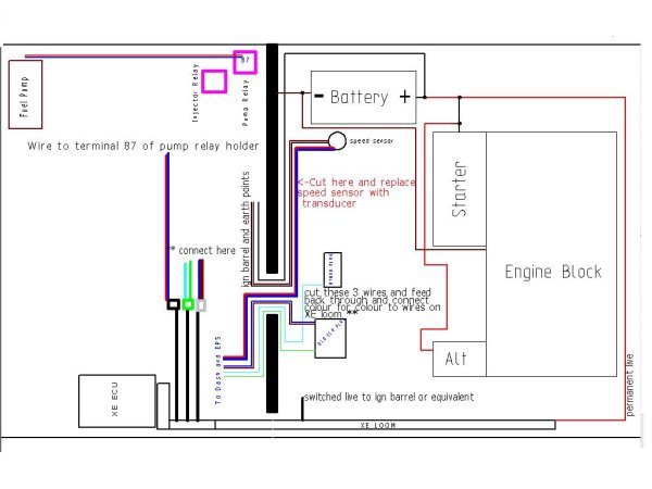

how difficult is the wiring when putting a c20xe into a 1litre shell?

not that different mate only difference really is that on the 1.0l the ecu is in the engine bay so you have to run the wires for the xe where there hasnt been any before other than that its pretty much the same

Someone posted this a while ago, I thought it would come in handy eventually....
[edit] its been resized in my garage... if you want the original size, let me know....
[Edited on 23-04-2008 by Mase]

23rd Apr 08 at 11:40   View User's Profile U2U Member Reply With Quote
original size please
