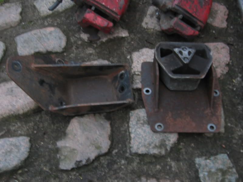

Could you identify what is in the picture and more importantly what isnt that i would need when doing a redtop conversion!?
Are those the correct mounts? Where abouts do they fit? Any help appreciated!

mount on the left goes on the gearbox to the nearside inner wing. one on the left is for a shell with pas/abs ie a gsi and goes on the offside inner wing. you then need another mount to bolt to this and then onto the engine below the thermostat. will need a rear gearbox mount aswell the goes under neath the bulkhead. the inner cv on the small driveshaft in the pic looks abit shady

'you then need another mount to bolt to this and then onto the engine below the thermostat'
Whats this look like then and where can i get one and how mcuh will it cost? Same goes for the gear box spacer! cheers

Chris astley sells them
