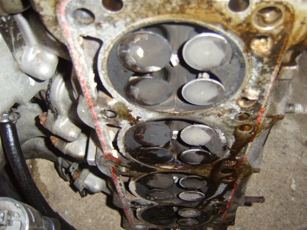

lee mitchell
Registered: 26th Jan 01
16th Jul 07 at 20:39   View User's Profile U2U Member Reply With Quote
16 bent valves and guides
also a stripped thread in the block on the front head bolt

Thats ace
get them out and stand them all next to each other
how the woodruff key brake? i hate them things i always thread lock them in as see them work there way out, i have been tempted to put a spot weld on them before now

I was told by vaux parts dept that you can no longer buy the crank pulley cog anymore?
was it the key on the crank or the pulley that broke?
lee mitchell
16th Jul 07 at 20:44   View User's Profile U2U Member Reply With Quote
the little lug part on the bottom pulley broke that locates on the crank. common problem so ive heard but first one ive ever had

the key is on the pulley, the crank has a slot dave

never seen that before, weld the cunt on
abit of hardcore cutting paste i am sure you can lap them back in

Looks like pretty much what happened to mine
thats what I said, isnt it
Ive seen this happen twice lately, x20xe and a x16xe. both times were due to garages not using a new crank pulley bolt during cambelt changes and not tightening them up properly.
mates did this on a c16xe. dont think its quite as bad as this one though.

happened on my x14xe i got away with minimal piston / valve contact though
does anybody use new bottom pulley bolts when do cambelt changes????

I always do, its £1.02 well spent. my parts dept usually throw one in with the cambelt kit anyway.

so how do you get the alternator belt pulley off to remove the cam belt covers to see the timing marks?

on a c20xe u undo 6 outer bolts to do the belt. the crank pulley stays where it is

What happened to mine when the bottom pulley bolt came loose

they look straight compared to my ones johhny

also looks like u did about 10miles on that head before it came loose

Aye true, yours are well and truly fucked
