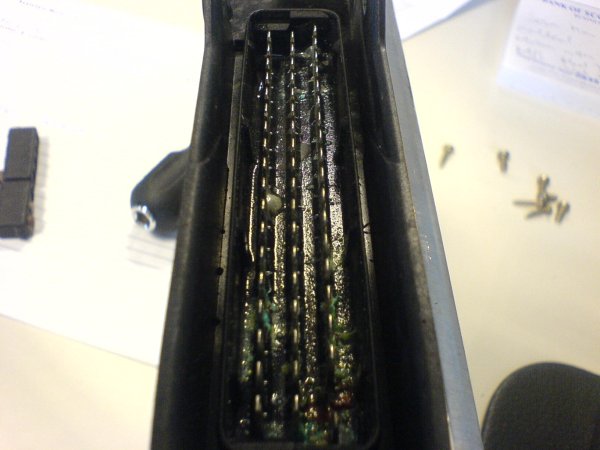

Started the car today, begged it to start first time and behave before I turned the key.
Turned it over, kept turning - No ECU Light. Booted the ECU Panel and the light started flickering then came on, starts up misfiring, pop pop bang bang.
Got to the lock up, picked up my tools, Spare ECU and spare fuel relay.
In the work car park, booted the panel again - Engine dies and no ECU light. Ah well. Something to do in my lunch hour

Wait for the next bit - The ECU was underwater.
Que the paper towels, paper clip to get out broken pin and a few choice swear words
Corsa 2.0 16v Vegas - Sold

25th Jun 07 at 12:11   View Garage View User's Profile U2U Member Reply With Quote

Beter find out where thats coming from

The water coming in through the bung where the ecu wires go into the engine bay? I had a leak there

Yeh, but I sealed it back up a couple of weeks ago when I was getting wet legs.
Water looks like it's been there for a while.

Bogeys in there too

Good to hear youve found the cause. Maybe windscreen seal leaking, or sunroof drainage.

Yeh had one spare from when I first bought my engine, So fitted that!
I'll have to wait and see what happens to it now. Dried it out with the hairdryer last night and she's good as gold
