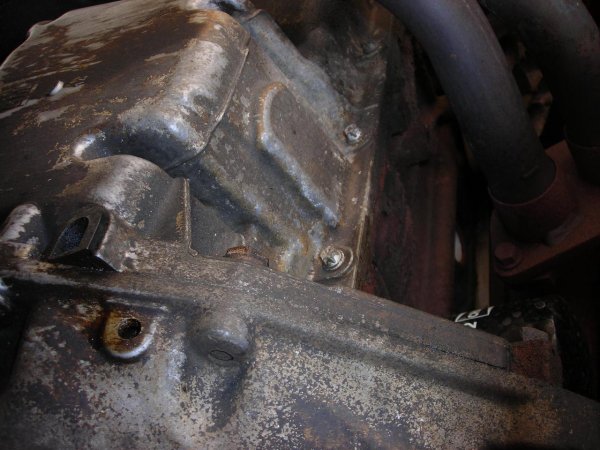

This is a hole in the gearbox housing next to the sump, anyone know what it is and why it has oil coming out of it lol?

4th Jun 07 at 16:41   View User's Profile U2U Member Reply With Quote
resize the pic
looks like a hole made for a bolt or plug or something.

Planty02
Registered: 5th Mar 05
4th Jun 07 at 17:05   View User's Profile U2U Member Reply With Quote
i think images are generally 640x480 on here mate (i think images are automatically changed to this in your garage)
Doesnt look like a bolt, theres no thread

craig_s
Registered: 5th Mar 06
Location: Birmingham Drives: mk4 astra gsi
4th Jun 07 at 18:25   View User's Profile U2U Member Reply With Quote
i dont know if anything should be in there but it looks like engine oil thats coming out of it.and that your clutch behind there so i think your rear crank seal may be nackered.
TheCam
Registered: 16th Mar 07
Location: Kirkcaldy
4th Jun 07 at 18:45   View User's Profile U2U Member Reply With Quote
is that a hole in your clutch cover? if thats oil coming out your crank oil seal is cunted

TheCam
Location: Kirkcaldy
4th Jun 07 at 18:49   View User's Profile U2U Member Reply With Quote
is it held out with 6ish bolts or torx (cant remember) if so take the cover off. if you can see your clutch then its your clutch cover. if you can see oil behind your flywheel get the crank oil seal fixed but not sure how much it would cost as you have to take the box out IIRC. plug the hole. there shouldnt be a hole there.
TheCam
Location: Kirkcaldy
that doesnt look like your clutch cover. that looks like the gearbox casing??????
Olsrey
Registered: 13th Jan 07
Location: Bradford   Drives: LET Vectra B
4th Jun 07 at 18:51   View User's Profile U2U Member Reply With Quote
Its attached to the sump mate
TheCam
Location: Kirkcaldy
4th Jun 07 at 19:05   View User's Profile U2U Member Reply With Quote
its attatched to the sump!?
any more pics at all mate?
DAZ1985
Registered: 3rd Sep 06
4th Jun 07 at 19:13   View User's Profile U2U Member Reply With Quote
looks like its in the bell housing of the gearbox to me

DAZ1985
4th Jun 07 at 19:20   View User's Profile U2U Member Reply With Quote
how far in does it go?
probs just a casting mark
Olsrey
4th Jun 07 at 19:23   View User's Profile U2U Member Reply With Quote
Ive no idea how far it goes it, but ive been having problems with my gearbox like it bouncing out of gear and it being "cruncher" than i remember
ainsley_brader
Registered: 24th Mar 02
4th Jun 07 at 19:37   View User's Profile U2U Member Reply With Quote
its just a drain hole in the gearbox bellhousing to stop it filling up with oil or water.
Oil is leaking from it from either engine (crank seal or sump gasket) or gearbox (input shaft seal or cracked casing).
The gearbox issue could be due to oil on the clutch ir loss of gearbox oil or just clutch worn overtime and completely unrelated!
