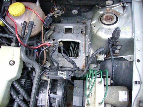

Also where is the best place to acsess it from, as im struggling as for some reason the battery tray etc in this corsa are all been welded in and cannot be removed like in my old one
I got some pics while i was out there today
What else should i remove to improve acsess?

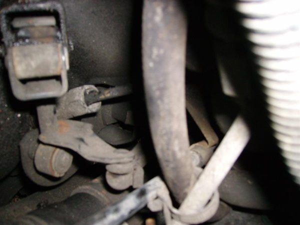

I shoved my camera down the hole in the battery tray and took some pics. Found this on the top of the gear box behind the selector arm. Is this it? Im assuming so as its the only thing there other then the reverse light switch
(the hexagonal thing with the wire/cable coming out of it)
If that is it how the hell do i get to it and how is it removed
