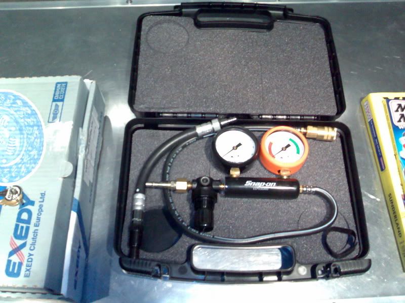

leakdown compression test is the answer mate.
jamesvalver
Registered: 21st Feb 03
22nd Mar 07 at 21:27   View User's Profile U2U Member Reply With Quote
that would show up the stem seals i guess
Dave A
Registered: 10th Dec 03
22nd Mar 07 at 21:28   View User's Profile U2U Member Reply With Quote
will show up EXACTLY whats leaking. mine showed up a 3% leakage past the rings, make sure they have a good tester such as a Snap-on one as the cheaper ones are shite.
and make sure its a leakdown test not just a compression test.
jamesvalver
22nd Mar 07 at 21:37   View User's Profile U2U Member Reply With Quote
i no we defo dont have one of them at work lol. how does it determine where its leaking through?
Dave A
22nd Mar 07 at 21:43   View User's Profile U2U Member Reply With Quote
a leakdown test is basicly using compressed air to determine cylinder leakage.
plug the compressed air line into the tool, put the other end of the tool into the spark plug apeture. get the cylinder you are testing to TDC on compression stroke so valves are closed, open the valve to 100psi on the 1st gauge and the 2nd gauge reads the amount of leakage from the cylinder as a percentage. you can find the scource of the leak by listening to where the air leaks from.
dipstick = air past piston rings
inside cam cover = air past stem seals
from exhaust = past exhast valve (not seating properly)
from inlet = past inlet valve (not seating properly)
up to 15% is acceptable, 10% is good anything below 5% is optimum for performance.
