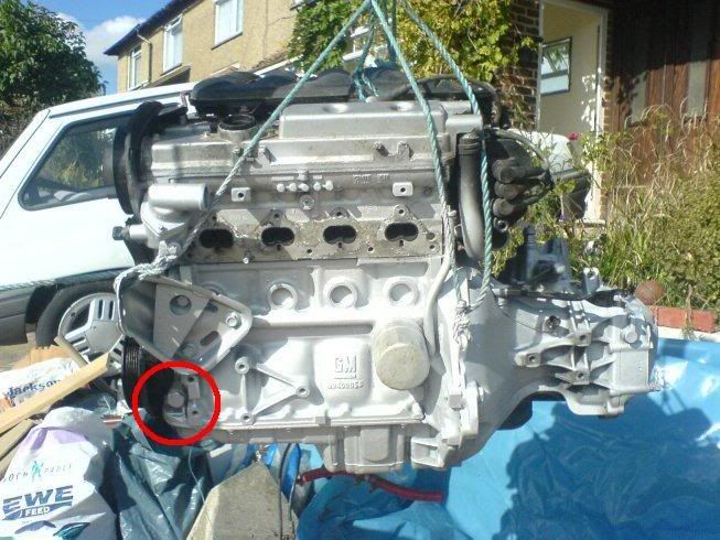

What is this for?
i undone it hoping to use the hole for oil pressure sensor and behind the bolt was a very long spring????
I squeezed it back in and done it up.
any ideas???
Whats the spring for?
Can it be removed?
Rob

Pressure relief valve iirc.
No it can't be removed.

Just use the oil pressure sensor hole on the back of the oil pump?

its a real bastard to get to.
Is there space enough for one of the normal vauxhall pressure sensors?

Should be fine yeah, that looks just a normal pressure sender you use for a oil guage/digidash, should fit fine.
Best way get to it is get the drivers wheel off and through the drivers wheel arch.

Its on a nova
Ill give it ago tommorow.
Any idea of the thread size? I take it ill need an adaptor?
Ill only be running the pressure sensor for the gauges and not a pressure switch so wont need a T-Piece

Do you just need swap the std engine pressure sender for a different one?
Just get a aftermarket sender with the same thread as the original vaux one.

The standard one is not actually a sensor, it is purely a switch, so if there is any oil pressure at all, it activates a switch, which turns off the oil light on the dash.

If he has a digidash oil pressure guage working then its a 2pin sensor.
Std there a 1pin switch.

im fitting aftermarket gauges so need to get an aftermarket sensor (same as the pic above) in there

Just get a aftermarket sensor with the Vaux sender thread. Sorted
