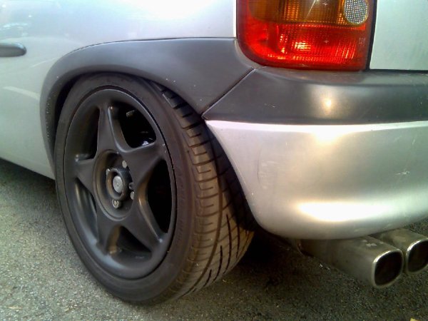

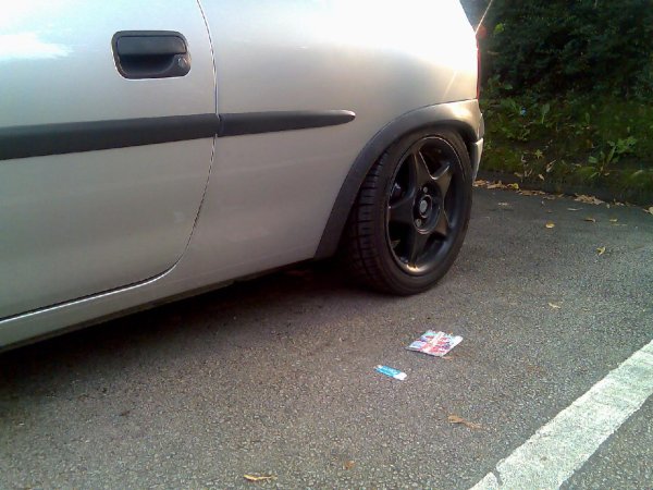

20th Jan 07 at 17:38   View User's Profile U2U Member Reply With Quote
here is 195/45/15 on Mistrals, lowered and loaded
I want to go for the 50 profile because of the harsh ride on the 45
