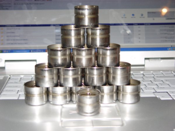

what do you mean by valve lifters?? hydraulic tappets??

9th Oct 06 at 21:40   View User's Profile U2U Member Reply With Quote
these things

Ive never kept them in oil but when you put new ones in they sound like a diesil engine for ten minutes or so. So I guess kepping in them in prevent that.
Ive soaked them in petrol to clean the up

they are well easy to take out and clean
first grab the bucket with a cloth and get a soft piece of wood, now hit the bucket agaist the wood and the lifter should fall out, eventually. no get a pointed tool like a small screw driver and press down on the small ball in the middle of the lifter untill all the old oil is out, now place it in a container of new oil and repeat, to fill it back up. u will be able to feel when it fills up and it should go smooth the more u pump it. now replace it into the bucket, it should fit back in with a click. now repeat for the next 15
worked very well when i did mine, went very quiet. some of the may take a bit to smack out but as long as u do it on a soft piece of wood u should be ok
if you want a more detailed descrition send me your email and i now have found the document and ill email it to you. it has pics to
