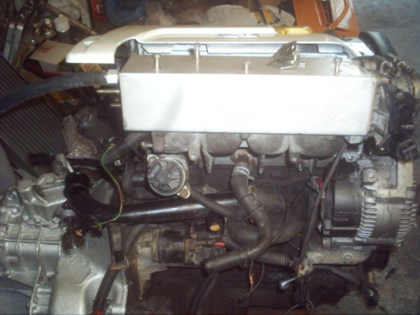

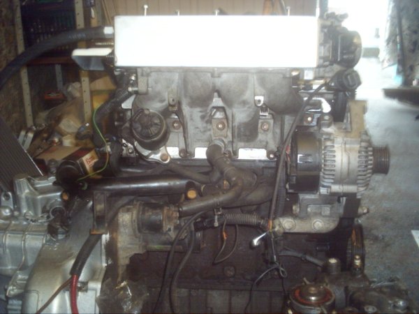

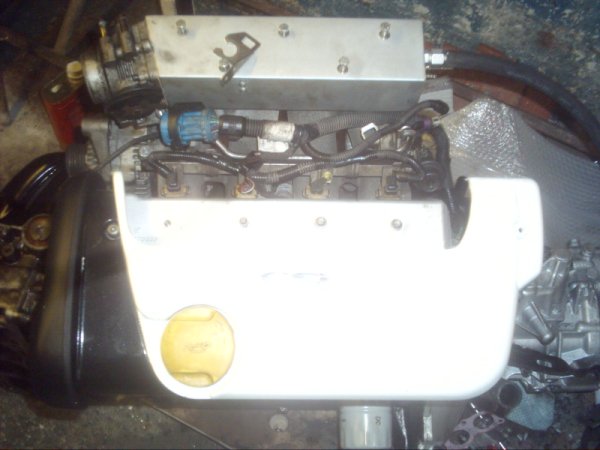

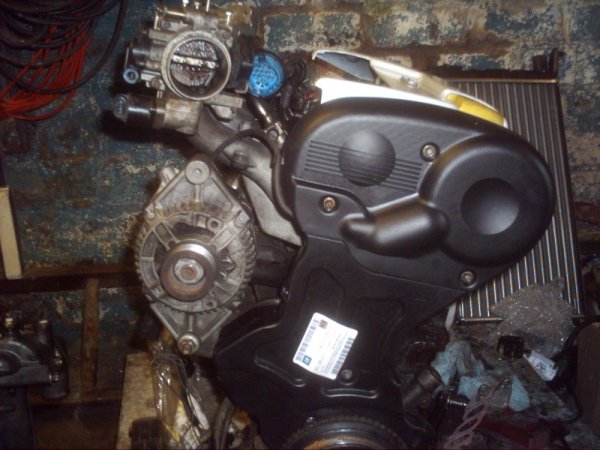

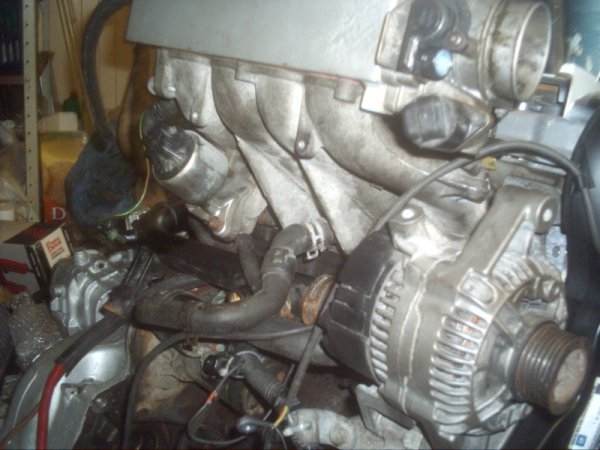

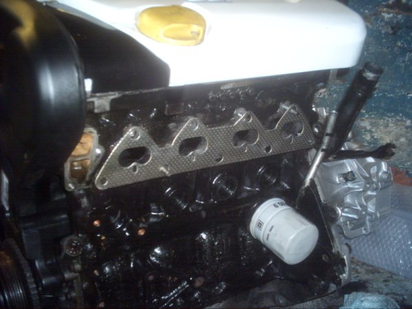

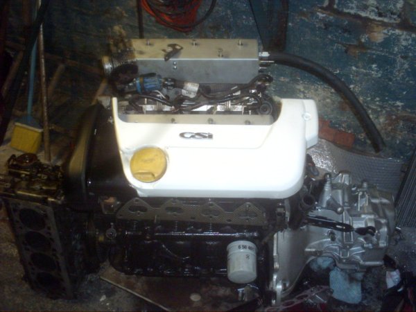

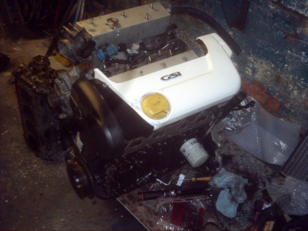

Pics below are of my engine thats going in the car in two weeks.
Just want to make sure I have everything.
What I dont have attatched are the coolant housing , the dis pack , hoses loom .
I have the ecu , transponder and chip.
Anything less obvious that you see I don't have , please reply
Cheers
Gregor

looks like the alternator is missing its top bracket?

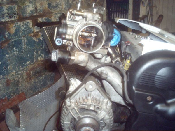

Alternator belt, take it you have that ?, while the engine is off give the throttle body a quick clean too. This bit you can see ...

Alternator belt tensioner, and as said the top bracket

unless.....you're not having power steering, in which case the top alternator bracket need bodgering, to double as the tensioner as well

like so

No it doesnt
You need a lower mounting bracket, belt and tensioner for a 95 1.4 16 sri without PAS or powersteering

well, either way will do it really.
I would use an arm like robhayes has and just run a belt without a tensioner. much easier.
p.s I have a bracket you can use. you would just need to get a few washers and a bolt to fit it. then a belt from halfords thats the right length

and clean that throttle body lol

Yep throttle body is a mess needs a good clean.

I've got my engine on my stand and my throttle body was worse than yours. I decided to clean it as I thought the last thing I wanted was air passing through a mucky throttle body into my newly rebuilt engine!
Anyway the gunk didnt come off easily, and I ended up taking the butterfly off the spindle to clean it properly, I noticed the head of one of the screws was pretty f*cked, went 2 vauxhall 2 get some replacements to find out that you cant get the individual screws, you have to buy a new unit for £313! lol!

exhaust manifold?
