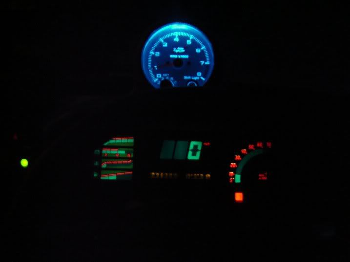

Thats mine i finished over the weekend mate. To change the colour of the lcd display you have to take it totally apart and put custom coloured films in behind the lcds. I think there is a pdf kickin about in german somewhere on how to build a digi dash with custom films etc.. ill see if i can find it and post a link to it.. if you have an y questions u2u me and ill see if i can help

that looks spot on mate like the colour blend. would be great if you could find it cheers

I scanned my original films and changed the colours in photoshop and printed them out on acetate. The colours werent as bright as i hoped but they still look ok. I was gonna buy some films off cobra148 i think but decided to make them myself.. the dash above looks sweet mate
