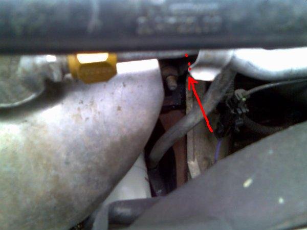

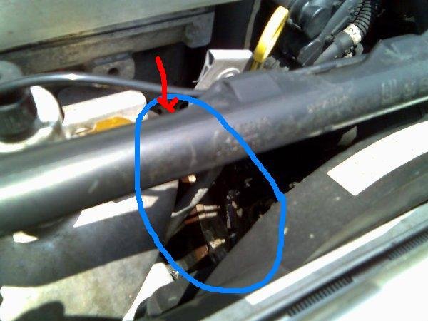

now can someone please tell me what is this:
2nd pic taken after some hard drive
some small drops on the ground too...
everywhere is ok...
what could this be?
[Edited on 21-06-2006 by abdus]
[Edited on 22-06-2006 by abdus]

what the join between engine and gearbox???
or the dipstick?
[Edited on 21-06-2006 by Rileysport]

not dipstick
it's leaking along the line between the engine and gearbox, coming from the engine side though...it's can be seen starting around here:
21st Jun 06 at 13:58   View Garage View User's Profile U2U Member Reply With Quote
is it not dripping down from the rocker cover gasket? they are rubbish, they always go.
what colour is the oil?
Rileysport
Registered: 18th Jun 04
21st Jun 06 at 13:59   View User's Profile U2U Member Reply With Quote
crank oil seal, sure its not running down the block from higher up ?

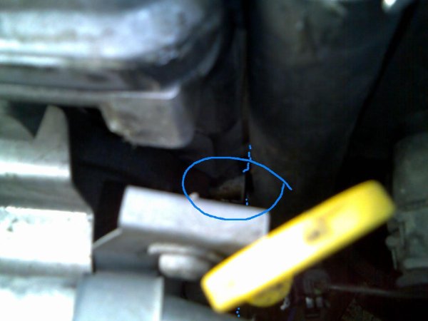

it's coming from up the block but dont know from where...will try and get a better pic using a proper camera later
from up here or somewhere around here

new pic:
really can't see from where it is coming from

Rob you were right...i am 99% certain it's coming from the rocker cover gasket...
it was changed 2 months ago
flash22
Registered: 13th Sep 05
22nd Jun 06 at 12:46   View User's Profile U2U Member Reply With Quote
its is the rocker cover gasket mines weaping from the same place at first it looked like it was comimg from behind the dis pack. Have a look where the gasket comes down over the hump on the front cam the pattern part gaskets have a mold/join line on that corner what makes it leak. also have a look at the breather pipes aswell as thay can weap and crack around where the clip is
[Edited on 22-06-2006 by flash22]
abdus
Registered: 23rd Feb 06
22nd Jun 06 at 14:12   View User's Profile U2U Member Reply With Quote
did you fix it? same problem it seems
22nd Jun 06 at 19:48   View Garage View User's Profile U2U Member Reply With Quote
problem with rocker cover gaskets is they tend to get overtightened
I went through 3 on my 1.4 and put a brand new one on the 1.6, and they ALL leaked
they are a total pain in the arse, and i dont know a good way of getting it sorted
