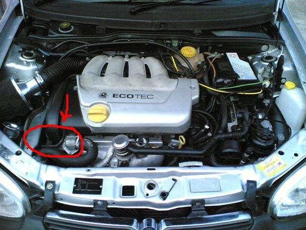

follow this wire, muct be down here

found it and have plugged in the spade connector works fine. cheers for your help,
going by the pic above its the same as my engine just wandering do you have a few plugs that arnt plugged in and hangin around or are they plugs that the mechanics didnt plug back in when i had the engine replaced?
