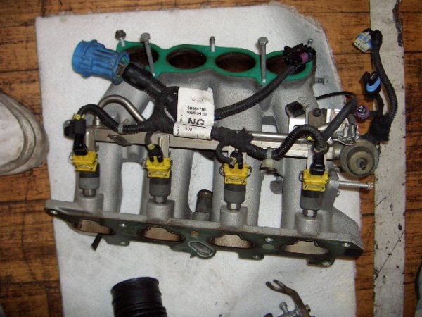

anyone know where this is?
i think its under ma inlet manifold on the left hand side.
my car isnt getting the correct fuel preassure so gonna change this.
any other ideas causing low fuel preassure??

cant find ma haynes lol, how does the filter come off? will pwtrol not come pissin out lol.
also anyone got pics of fuel pressure regulator?

changed the filter made pretty much bugger all diference, how do i change the fuel pressur regulator??
ajscorsa
Registered: 30th Apr 02
19th Mar 06 at 16:36   View User's Profile U2U Member Reply With Quote
ttt
RCoughtrie
Registered: 31st Oct 04
19th Mar 06 at 16:43   View User's Profile U2U Member Reply With Quote
have you found it on you engine ?
If so it should just withdraw after you have taken the three bolts out
ajscorsa
19th Mar 06 at 16:56   View User's Profile U2U Member Reply With Quote
ive found it but trying to get to it is gonna be a cunt
canna be arsed with it today lol do i need to take inlet off and expansion tank and battery out to get to it like i did the EGR/
