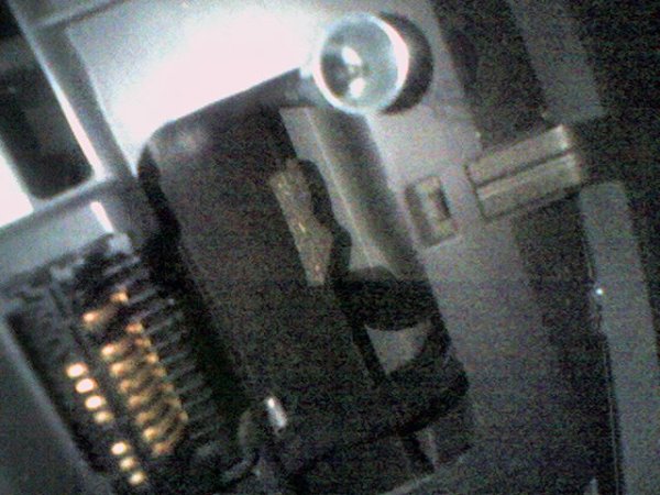

I have taken my dials out and been informed that for the rev counter, i need a green wire to put into the back of the new dials. I cannot for 1,000,000 quid find the wire
I have a pic *sorry about the angle * tilt ur head to the right, will make more sense lol
Thats all i can see lol
Anybody shed some lights onto this?

this may seem obivous, but have you lifted the dash plug out of it mount, then you can see all the coloured wires. Altough you prob have

what do u mean? im confused which is the dash plug?

The one with all the pins. Push in the clip(s) and pull it out?

the 1 in the pic with all the gold pins on it there yeh?

have you go tthis green wire?
should also be here...

yeah ive got that
