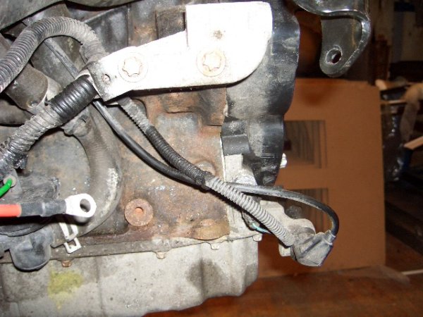

following on from your u2u's jason, i thought i would post this up. its a pic of the crank sensor. (bottom right bit sticking out with the wire going to it)
check its on tight and not damaged. sometimes gets knocked about when doing a conversion due to the position of it.

ok where by in the engine bay is that then mate? it was fine just gone all of a sudden so doubt it was done in the process of the converison maybe later on?
Dave A
Registered: 10th Dec 03
26th Feb 06 at 18:31   View User's Profile U2U Member Reply With Quote
timing belt side, closest point to the floor.

ok so il need to get under the car?

take it out clean it?

as suggested yesterday look att he crank sensor and check the timing if its getting the incorrect rpm signal the timing could be out
