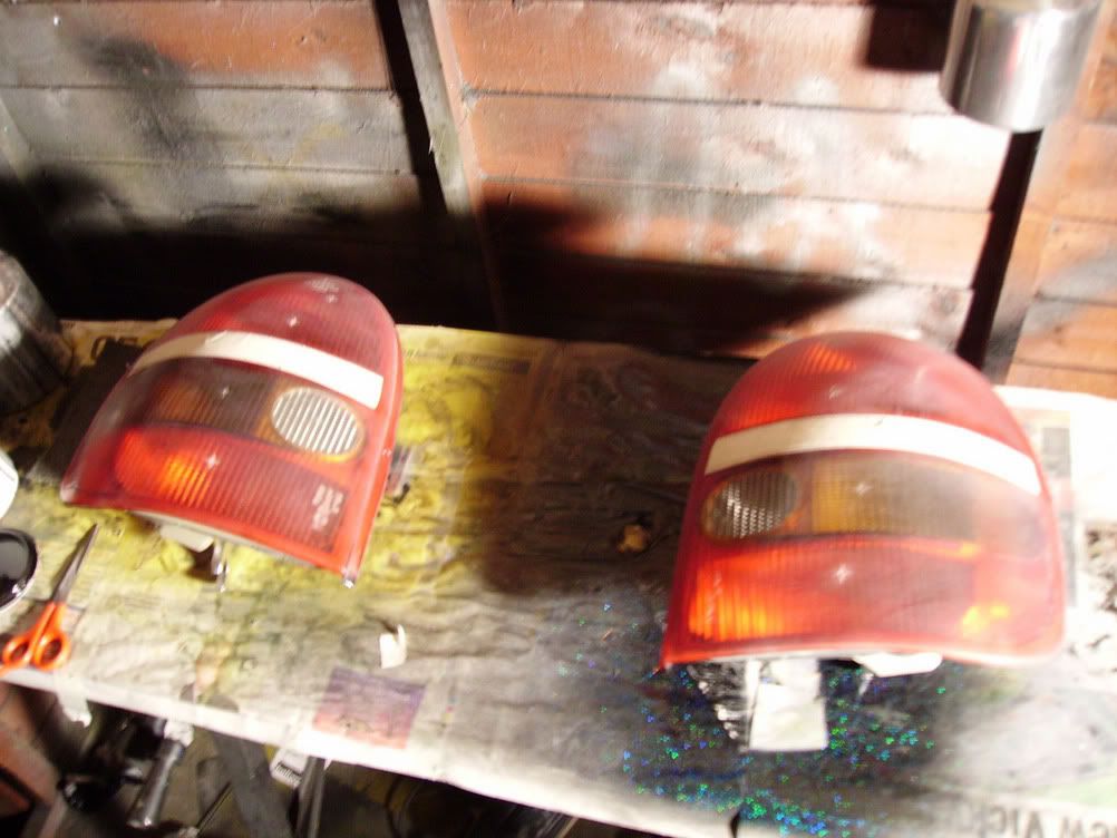

For this I used:
Spray Gun (substitute with custom mix spray can from halfords £10)
Compressor (not needed with spray can)
Black Paint
Clear Laquer
Scotch Pads
Masking Tape
Follow directions of the product manufacturers and if not sure, ask!
Step one:
I masked off the reflector but this doesnt need to be done unless you want to keep it legal.
Step 2: I used a scotch pad to rough the surface up a little.
Step 3: Mix a SMALL bit of paint with clear laquer (or have a spray can mixed like that at your local halfords, i used too much black for my liking) and give the lens light, even coats.
Step 4: De-mask, stand back and admire (or decide you dont like them if your like me).
Images are on photobucket, if they become inactive u2u me as they may still be on the computer.
Craig

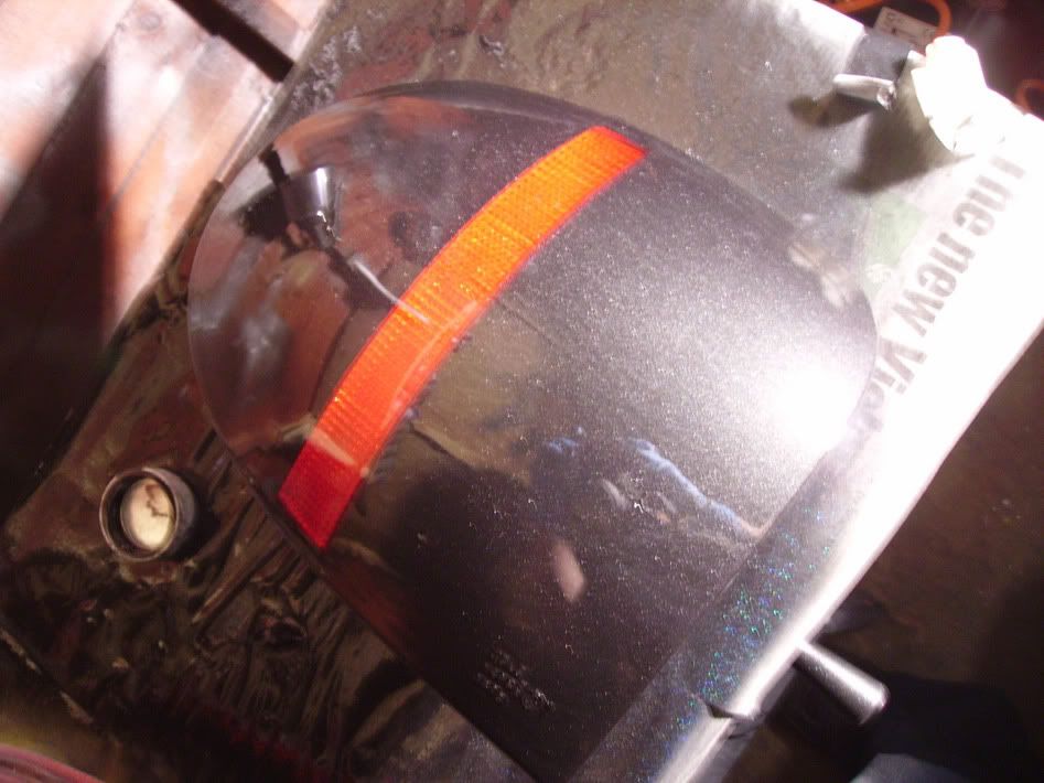

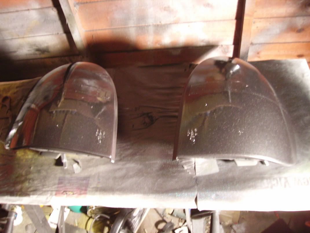

good tutorial, but it looks like those lights now have a fliake in the paint?was that the intention?
craig8
Registered: 31st Dec 04
1st Feb 06 at 21:34   View Garage View User's Profile U2U Member Reply With Quote
it was a metalic paint, was the only black paint i have at the moment
good side is theyre the same colour as my wheels

Good stuff, but needs rubbing down with water and wet n dry
craig8
1st Feb 06 at 22:01   View Garage View User's Profile U2U Member Reply With Quote
they'll be getting stripped down now anyway, spilled thinners on them while cleaning the gun but i'll re do them at some point soon with a flat black basecoat, then they'll get flat and pollished

Whats happened on them last two pics is that how they turned out after spraying them or is that because you spilled a load of lacquer on them.

1st Feb 06 at 22:28   View Garage View User's Profile U2U Member Reply With Quote
the two lines?
if its the same as im thinking, theyre reflections of the inside of the shed
