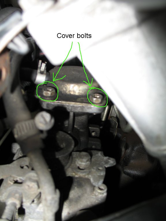

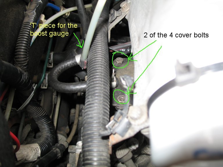

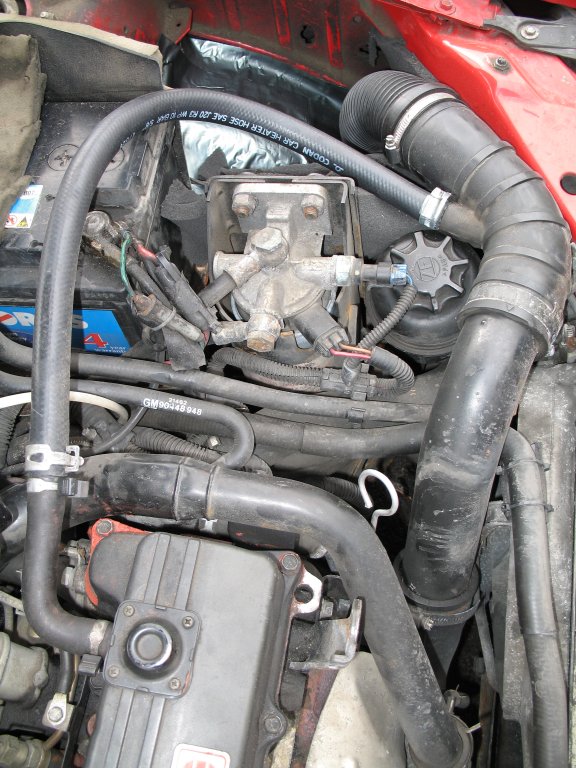

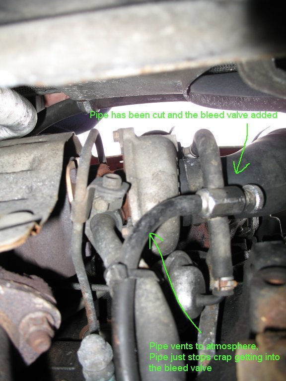

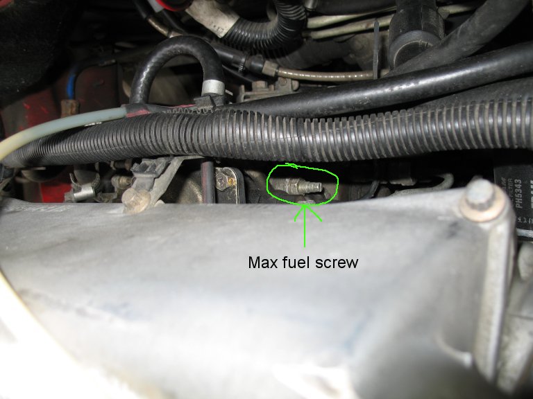

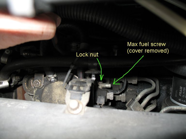

I have taken some more pictures and sent them to the mods asking if they can replace the missing ones.

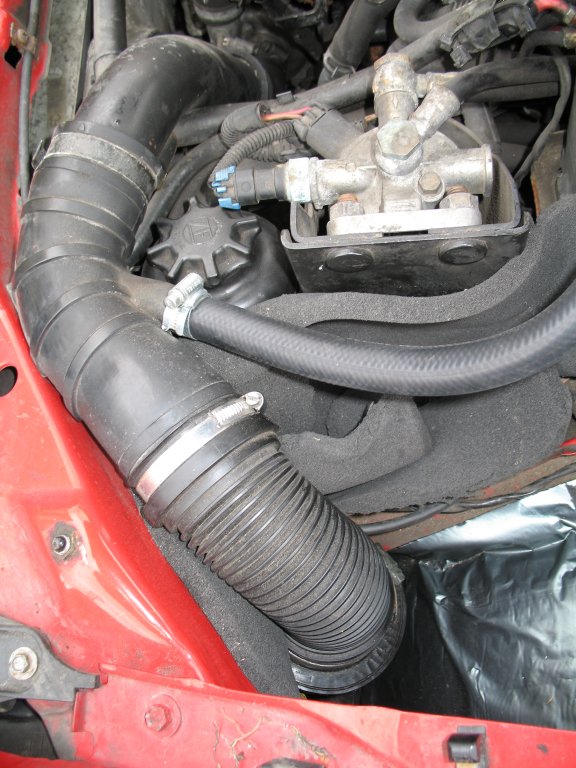

corsastev - If you do the mod and drive the same way you will get the same MPG but I tend to drive it harder as it perform's better.
Michael B - It is possible to do the mods by working around the inlet manifold, you may get a couple of scraped knuckles but it's worth it.
I have recently also changed the intake to a cone filter and this makes a further improvement to the performance and economy:
Without the mods = 52mpg
With the mods = 48mpg
With mods and cone filter = 50mpg
I'm sad and record the MPG for every tank full so I have a good idea the differences after each mod.
Another thing I found to make an improvement is re-shimming the valve clearances, when I checked mine they were way to tight and adjusting them made the mid range pulling much better.
Standard the 1.5TD boosts about 7-9 psi, the difference after the mod is not just the fact you boost higher, the boost pressure increases quicker at lower revs so you get much better pulling power at lower revs, the extra maximum boost helps to stop the power trailing off at higher revs.
Anyway here's some pics that may help you guys out:
http://www.duck.eclipse.co.uk/corsa/maxFuel1.jpg
http://www.duck.eclipse.co.uk/corsa/maxFuel2.jpg
http://www.duck.eclipse.co.uk/corsa/cover1.jpg
http://www.duck.eclipse.co.uk/corsa/cover2.jpg
http://www.duck.eclipse.co.uk/corsa/bleedvalve.jpg
http://www.duck.eclipse.co.uk/corsa/airfilter1.jpg
http://www.duck.eclipse.co.uk/corsa/airfilter2.jpg

lol thanks very very much for the pics and the info its so hard to find out how to mod this engine i only use my td as a daily driver but its still nice to be able to make progress when i need to. thanks so much for the pics i would never have thought about movin the intake pipe round like that its helped me a great deal. just one question though on yr bleed valve is it not connected to the acutator at all now? the pic obscures my view of the pipe im not sure weather you have a t piece in their to vent to the atmospher and connect to the acutator or jus vent so could you jus confirm this for me please. and thanks again for the info im gonna do the boost mod next week some time

Thanks printing these off and will try this mod over the weekend, will post back how i got on!

Some Questions: You are running the cone filter directly off the turbo .. is it better? What bhp r u getting? Have you got a pic of the whole engine?

corsastev - the pipe to the actuator is cut and the bleed valve connected between the two parts of the pipe, the middle pipe off the bleed valve is were the excess pressure is bleed off, I stuck a piece of pipe on it and routed it away from the road to stop crap getting sprayed into the valve and blocking it up.
The actuator works as usual but by bleeding off some of the pressure the boost is allowed to increase above the standard amount, bit difficult to explain but for example if the actuator would normal operate at 9psi (maximum std boost) by bleeding off 5psi worth of pressure the actuator would not operate until 14psi pressure.
My corsa is also my daily hack and these mods will make it much more fun to drive, being able to keep up with regular traffic without any problems is nice.
punkymt1 - Connecting the air filter directly to the turbo has made a good increase in the performance, I had to adjust the max fuel screw when I did this mod as due to the extra cooler air getting in I could increase the fuel and so the power, by connecting the air filter this way the air bypasses the hot inlet manifold on the way to the turbo. I've never had the car on a rolling road but KrisTD managed 99bhp with these mods, I'm not sure I have that much but one thing I can say is it is a huge improvement over the std 1.5TD.
I'll try to get a pic of the whole engine over the weekend.
Michael B - By carefull adjustment of the max fuel screw you can make the emissions as good or bad as you want, the more black smoke the more power you will have, it takes a few attempts to get it perfect but when accelerating in 2nd or 3rd gear if you don't see any black smoke in the mirror then your good to go, I've yet to fail an MOT on emissions.
Just remembered something else I have done to the old corsa that also helps sort out the smoke when accelerating - I have cut open the catalyser and removed the contents, the cat was half blocked with black crap and I think this is were the soot builds up when driving slowly and this is why you tend to get a black clound of smoke when booting it after normal driving.

One thing with the airfilter mod is you get a bit of induction noise in the car, you can also hear the turbo whistling (spinning up)

Have to say the results are amazing. I screwed the diesel pump just over a 1/4 and its running sweet, no somke really, but lots of poke!
But what a bitch it was to do, my hands are all cut now lol.
A wee tip, in the diesel pump when you are removing the restrictor, dont cut it, just screw the top off the rubber thing and lift it out, will save you loads of time!

Thanks again for the pics, they helped a lot!

Michael B - you need to get a boost gauge and bleed valve to get the most out of these mods, at the minute you will be getting more fuel but the turbo boost will still be the standard amount, once you have the boost up to 14psi (nearly twice more than std) you will notice another improvement in performance.
