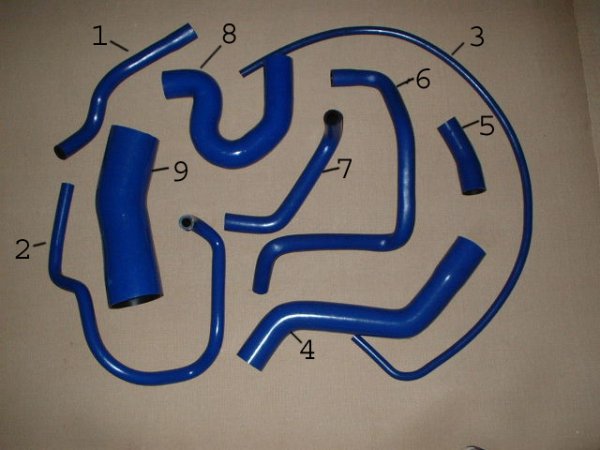

can sum 1 please label these pipes to where they go from and too??
cheers people

1. passenger heater matrix
2. top of rad to right of header tank
3. left of heater to under inlet manifold (there is far to much of this so i used some for the rocker cover to throttle body pipe
4. bottom rad
5. rocker cover to dipstick breather
6. side of cyl head to driver heater matrix
7. ?? i used it for rocker to throttle body but i think it may be bottom of header tank to the black plastic pipe on the back of the block
8. top rad
9. afm to air filter

y would they be different??

big fat one on the right is air filter inlet thingymajig
thats all i can do...

9 - air fliter inlet thingymajig

9 - air intake pipe

is numero 9 available to buy seperatley?
I think Turbo Chris has a couple left, he posted his remaining stock a couple of days ago.

do you know if it comes in shorter sizes? my filter sits right up against the slam panel, so need it to be further back.

You can always cut it
