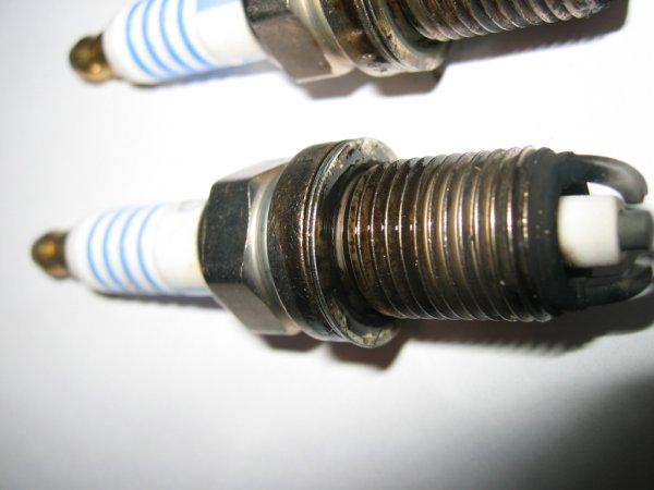

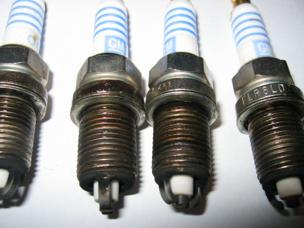

just serviced my car and changed the sparks plug, there is a bit of tar like oily stuff on the plugs, whats this mean??? is it over fueling??? it dont burn oil at all really! its a bit tuned?

Oil Fouling - Wet Oily Deposits
Fault: worn bores/piston rings or valve guides, sometimes occurs temporarily during new engine running in period

hummm but it coule be that the car may be over fueling as it dont use any oil!?

pahhhh enuff with the ideas, had a proper look and found the problem, i replace the rocker cover gasket and the little 'o' rings on the bolts may have slipped causing it to leak fro mthe top, its ok after all i think

7th Nov 04 at 14:59   View Garage View User's Profile U2U Member Reply With Quote
here are the pics

Them plugs indicate one healthy engine i think
all good soon to be healthyer!

them plugs are fine

cheers man, just the oily stuff on them made me wonder all seems to be ok then
