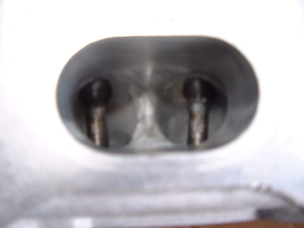

as title and would it affect the running off the car if i put it back on
astravanman
Registered: 4th Apr 04
16th Oct 04 at 11:21   View User's Profile U2U Member Reply With Quote
the bottum to

actually the bottom left doesnt look right at all

aye, doesnt look like its siting properly, did you do a compression test before the head came off?

bottom left looks like it has been coming into contact with the piston, and it doesnt look too centralised.

the top right hand corner of the head looks a bit rough too..

yeah thats what i was thinking, sure its supposed to be flush, thats maybe where your leak was coming from.

stand the head on its side and tip parrafin or petrol into the ports, you will see if it leaks past the valve quite easily.
Also I thought youd had the head skimmed or is that a different one?

that head is fucked no wonder the gasket went, take the cams out so all the valves are shut but that does look bent.

It doesn't look good, do as Ainsley suggests.
Dont put it back on with bent valves.
Strip the head and put the valves in a drill to see how true they are.

think its time for a mini rebuild there. replace the lot IMO
16th Oct 04 at 19:48   View User's Profile U2U Member Reply With Quote
Get a new head with the pourus repair modification done on it. Then swap all your gear over, but replace any parts that need doing.

looking at the top of that picture above number 3 cylinder it doesnt look like it was skimmed, if it was it was a piss poor job. Have you got a picture of the full face of the head.

thats what mine was like lol what can i do bout the valve and how can i fix it and what do i do lol
16th Oct 04 at 21:41   View User's Profile U2U Member Reply With Quote
put a new one in

You'll need to buy a new valve, have the seat re-cut and have new guides out in for the damaged valves. It might be cheaper to get another head, I picked one up for £40 a while back.
