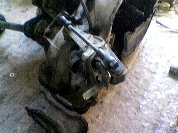

31st Aug 04 at 17:28   View User's Profile U2U Member Reply With Quote
One F20cr Gearbox linkage:

I'd agree... To shift the WHOLE lot 15mm instead of extending the linkage...

to extend the linkage do that

just that bit?
that's the f20 linkage though, and you need to use the f15 item where that part is plastic.
cheers for the pic though.
problem at the moment is trhat the linkage fouls the bulkhead when you try to pull back into second or fourth.
