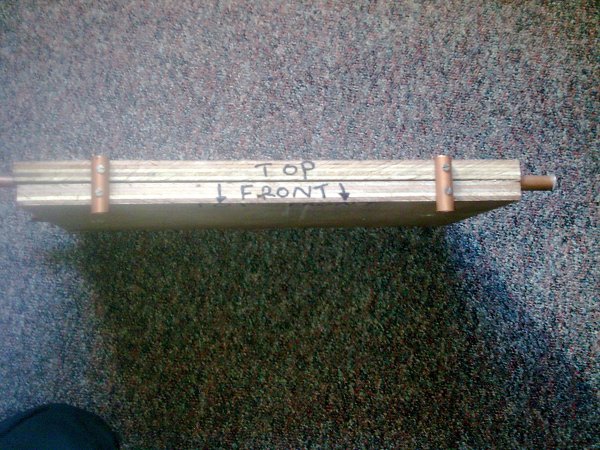

also mocked up a pre rad for the charge cooler today just got to get it made then its all out to get it all fitted!
[img][/img]
[img][/img]

Who is gonna make the rad for you?

pro alloy are making it for me.
