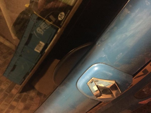

18th Jul 15 at 09:34   View Garage View User's Profile U2U Member Reply With Quote
18th Jul 15 at 09:35   View Garage View User's Profile U2U Member Reply With Quote
Fitted the most expensive solution to removing the rear wiper I've ever bought. Saved about 1/2 a kilogram!
