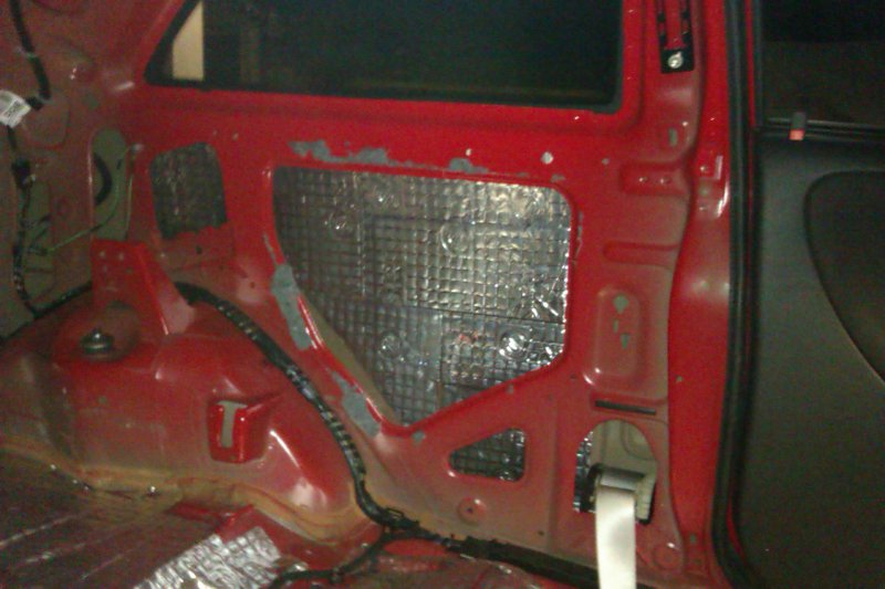

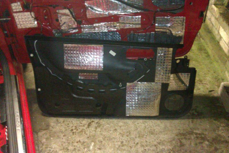

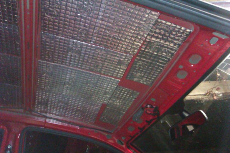

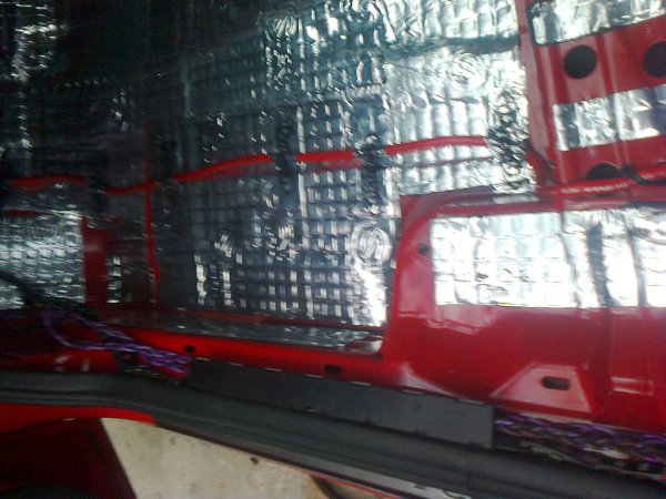

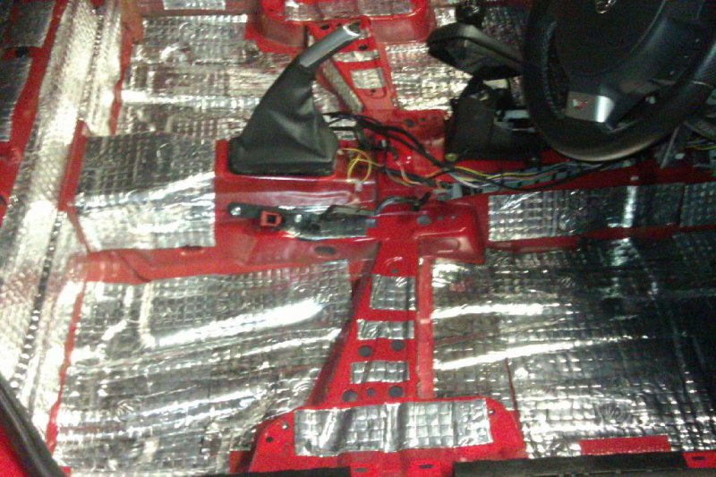

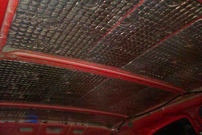

stripped the interior today to start fitting the sound system, made a start on laying the sound dampening. done the roof, boot floor, under rear seat, and the outer rear quater panels. 35 sheets used another 45 to go!

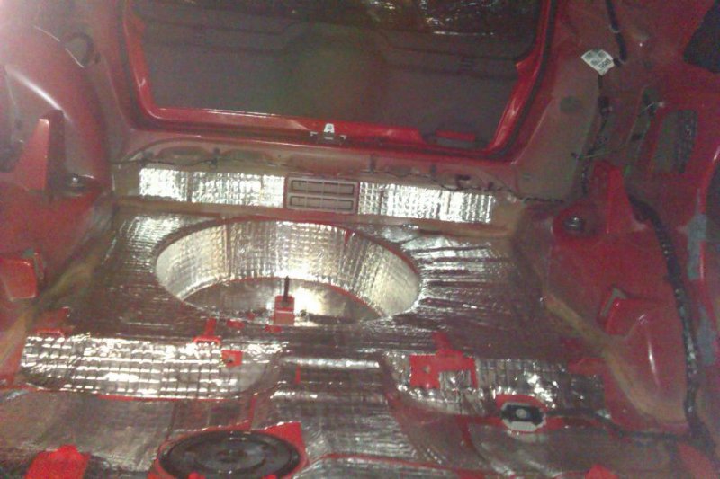

[img][/img]
[img][/img]
[img][/img]
[img][/img]
[img][/img]
[img][/img]

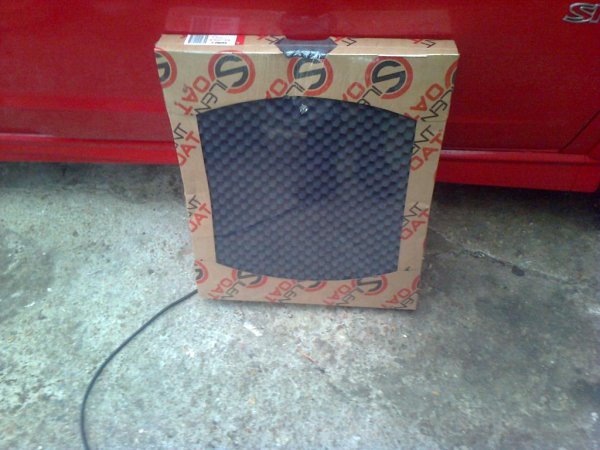

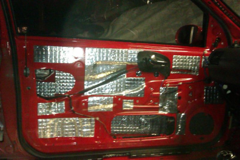

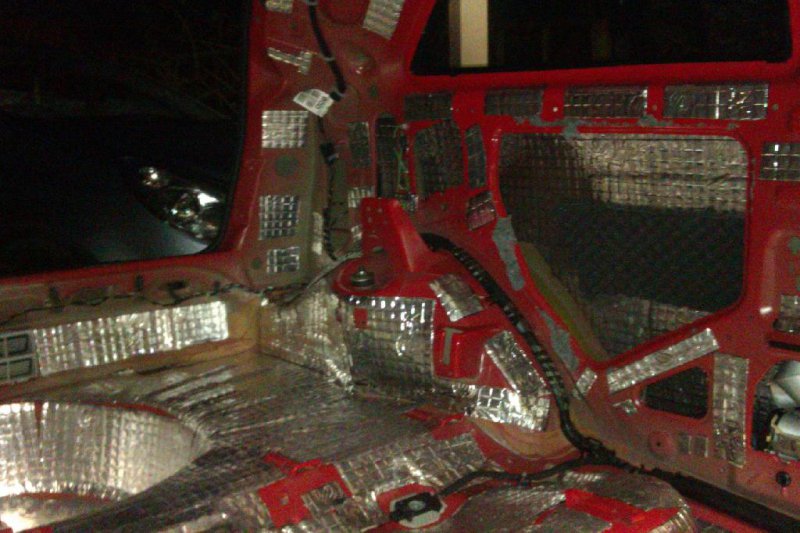

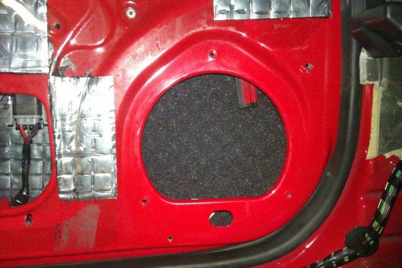

finished fitting the sound deadening today, total of 80 sheets used. aprox 8sq metres. had to go and get some sound abbsorber for behind the speakers in the front doors.
crack on with running the wires for sound system tomorrow then refitting interior.

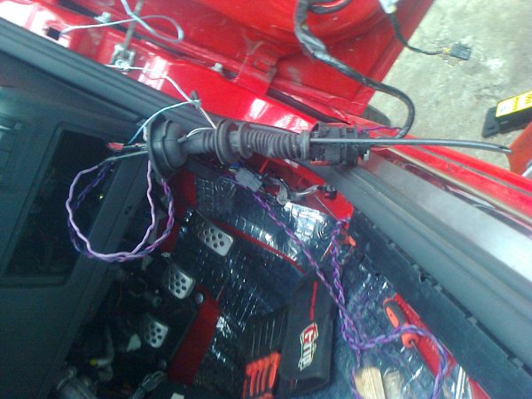

drilled out door plugs to route wires into the doors, used plastic tube to thread wires through the rubber boot and then pull through the plug.

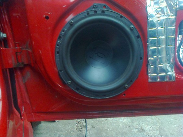

[img][/img]
[img][/img]
fitted MB Quart QM218.61 Q speakers to the front doors, not happy with tweeter location but ive had a better idea of how to fit them more stealth looking. also fitted crome door handles while apart.

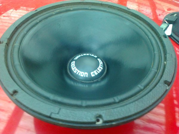

[img][/img]

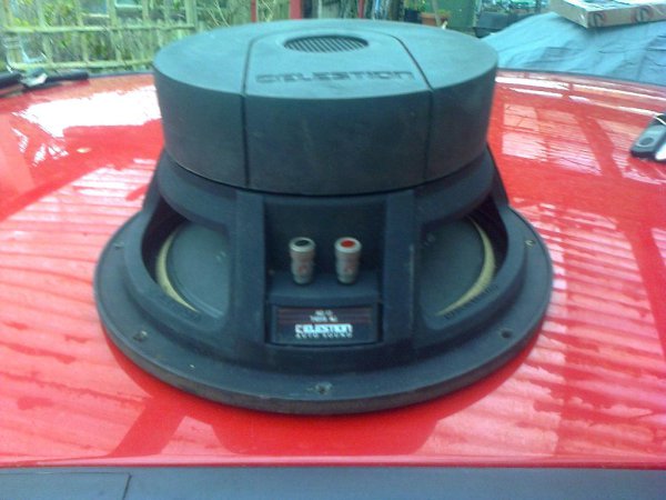

got the sub cabnet made for my old cavalier in, not much boot left though. still need to finish it off, retrim to match corsas carpet and make covers for the amps and other bits.
[img][/img]
[img][/img]
[img][/img]

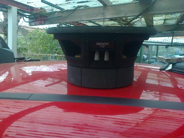

these are the subs im using, got it all in bar the second battery today. i got to cold!

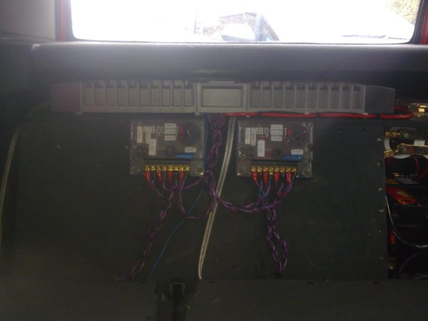

i'll get some photos of the system up later. the amps, crossovers, battery, etc. doesnt look to good as the cabinet's been around for over 14 years and wasnt built to fit the corsa. needs a freshen up.

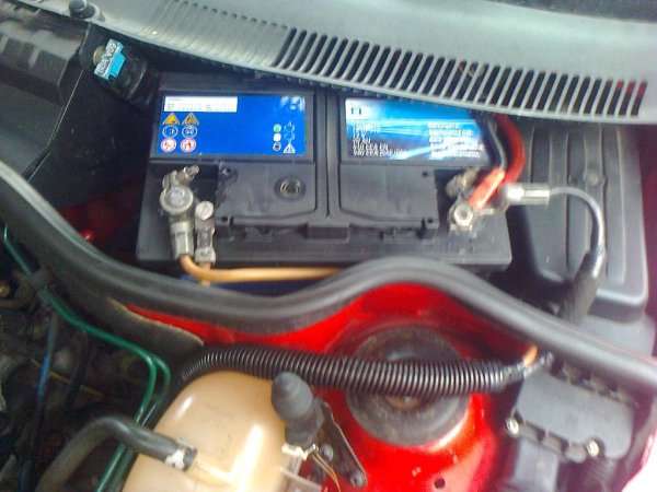

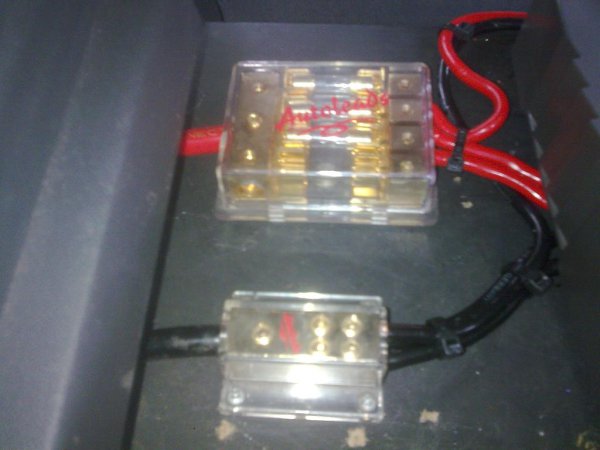

drop tested the battery this morning to find a cell had failed
so off to vauxhall and have my wallet raped for £87! largest battery fitted to the corsa C by vauxhall.

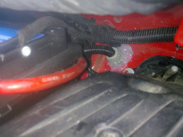

[img][/img]
heres a photo of the power wire where it goes through the bulkhead. ive used and electrical bulkhead fitting and plenty of silicone as dont want any leaks of risk of wire chaffing.
[img][/img]
connected it all up fitting the new battery on the car and the cars battery in the boot for the system.

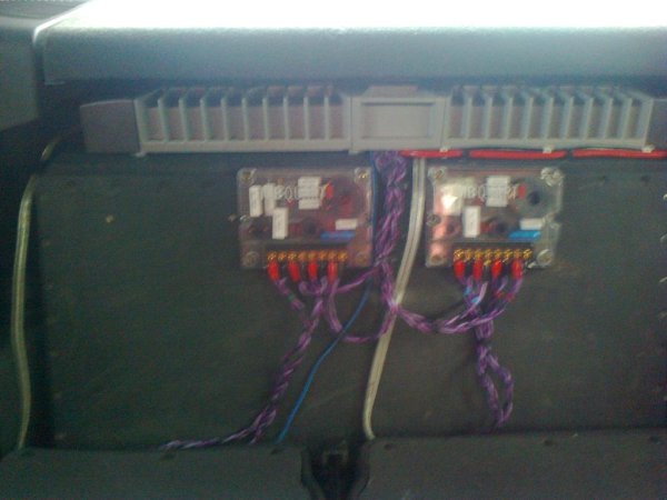

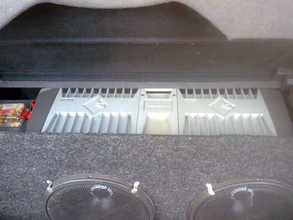

hers afew shots of the system.
[img][/img]
[img][/img]
[img][/img]

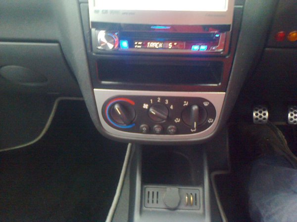

while i was out i called into the breakers and found a piece of black trim for around the heater controls as i dont like the alloy effect trim, this piece has been on my list since getting the car in november 2011.
[img][/img]
[img][/img]

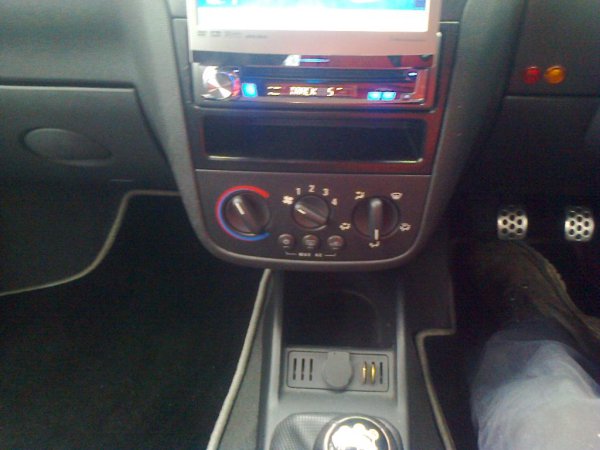

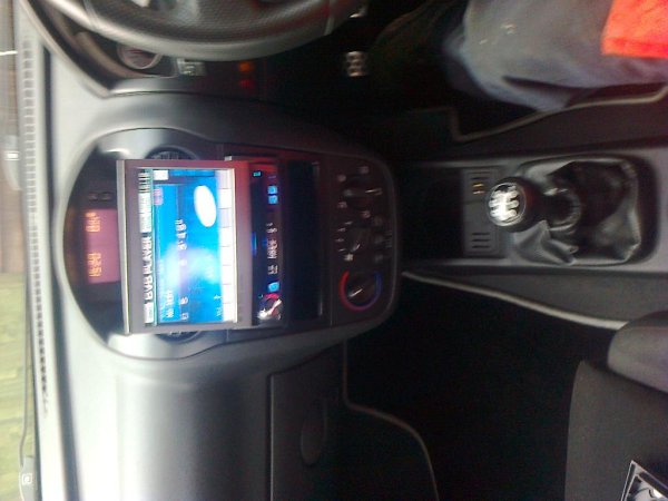

heres the head unit screen open and closed.
[img][/img]
[img][/img]

tried it out and the first track that came on from cd left in player was snap rhythm is a dancer, few more old skool tunes then in with test cd to set levels, balance, phasing and check for rattles and vibrations.
all good out side but still needs more sound proofing around the boot and rear trim panels need some foam behind them to stop vibraions at around 45Hz. otherwise happy dayzz!!
