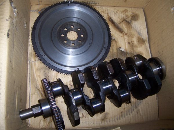

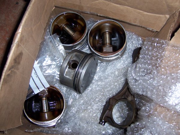

picked up my parts from the machineists this afternoon.

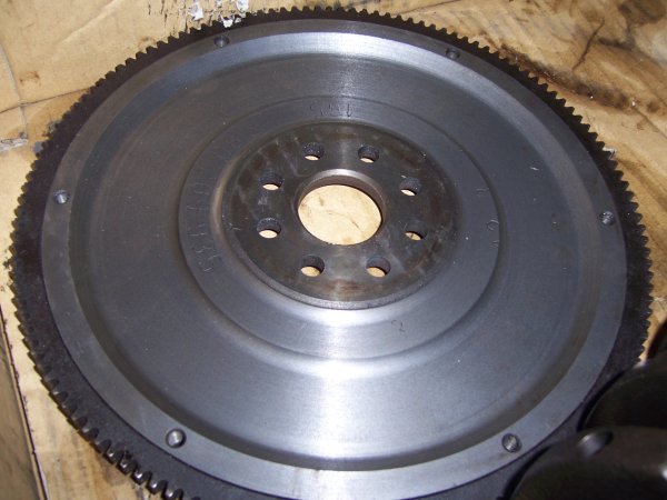

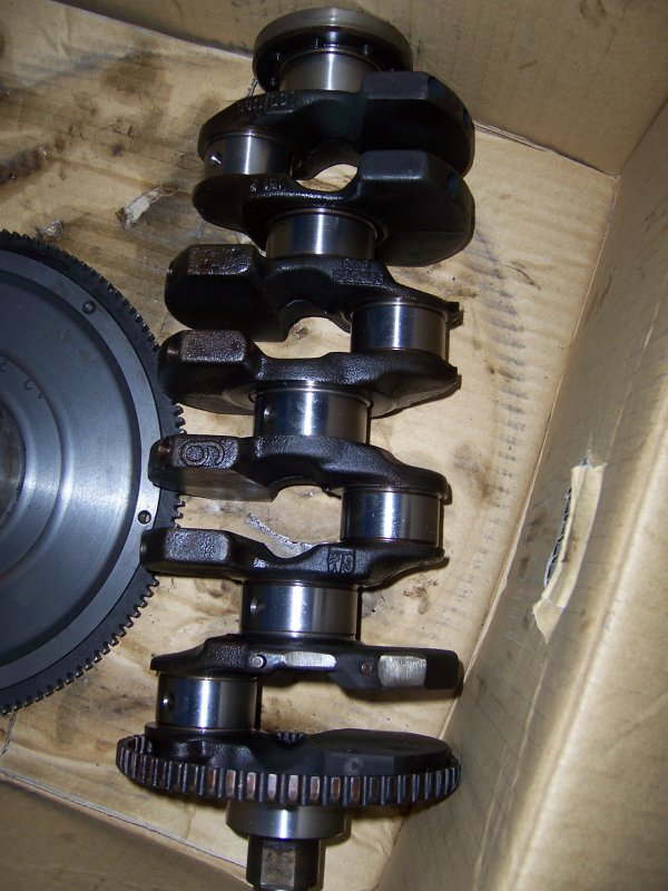

lightened flywheel and balanced crank -
close ups -
pistons and conrods -
work carried out -
lightened flywheel - £35
reface flywheel - £12
balance crankshaft/flywheel and rods - £45
polish crank journals - £26.55

did you not get the crank balanced with the flywheel fitted?

robhayes - yeh it was balanced on the crank all together

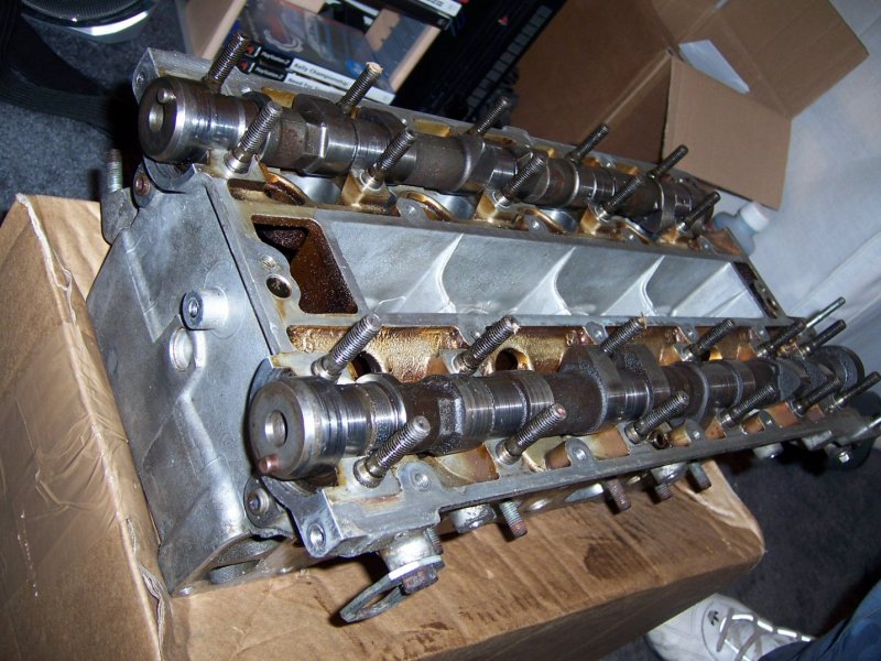

todays progress 08.03.2007
head skimmed -
decoaked the ports during my lunch breaks at work -
new cams sat in head -

very nice work u shud of had bigger valves fitted+gas flowed mmm more bhp

this head isnt goin on my new engine mate. this is goin on the engine im running atm as i want the cosscast for my new engine, so in 2weeks time in changing the top end on my current engine

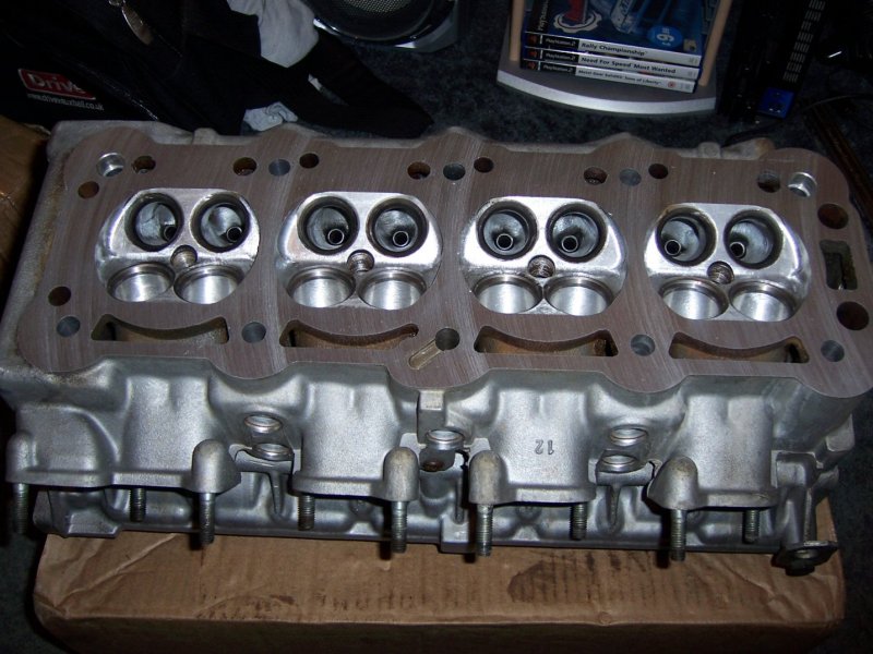

new cylinder head is all rebuilt now ready to be fitted next week. also plan to get the rollcage in finally!!

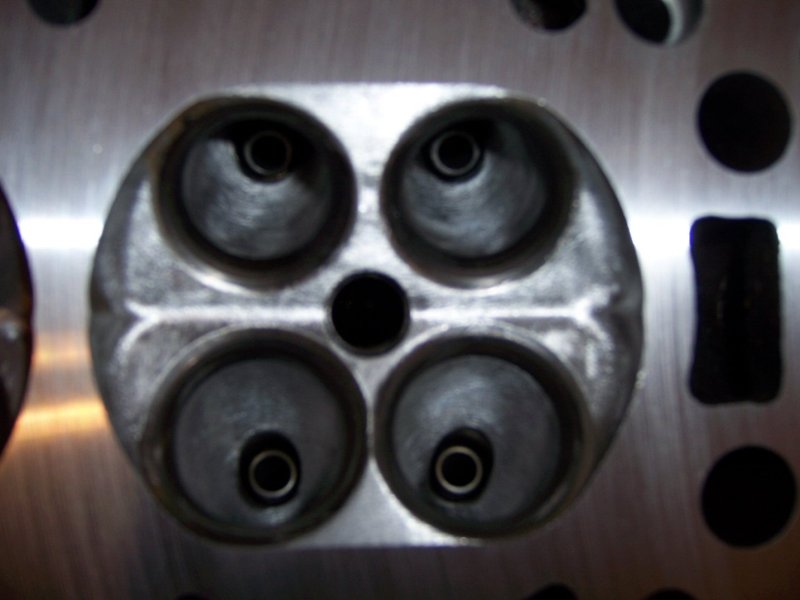

You say you fully rebuilt the head, what excatly did you change/renew? Thanks
jamesvalver
Registered: 21st Feb 03
20th Mar 07 at 13:50   View User's Profile U2U Member Reply With Quote
the head was decoked, and cleaned, valve stem seals were replaced. all valves removed and cleaned on a wire wheel then lapped into the head, and then all put back together. there isnt alot to the head really.
