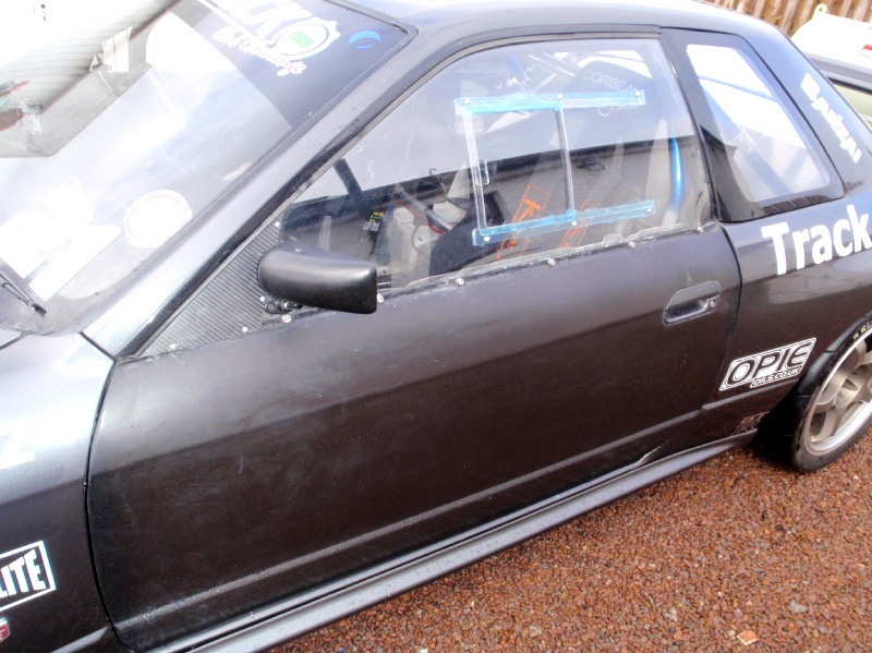

some updates
doors, sliders, firewall, mirrors, cage door X bars and lexan windows
